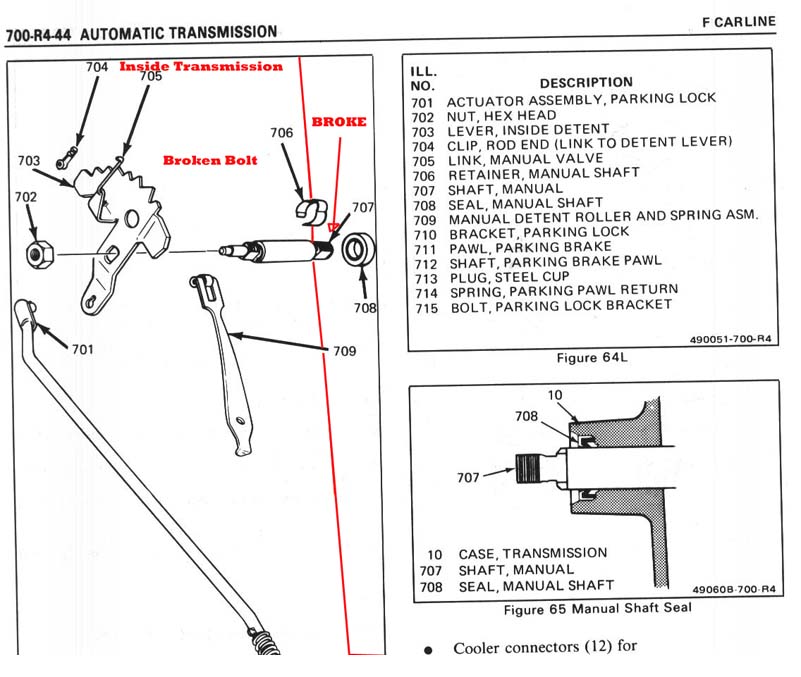

Hey guys heres the story......
i got a B&M shifter and while installing it we (POSBIRD87) broke the shifter linkage bolt......
how do i get the bolt out, get a new bolt, repair it, etc...is it possible?
this is really frustrating... i need fast replies too cause i have till tomorrow to fix it or im carless all weekend.....(sunday nothing is open, even scrap yards)
thanks so much guys, its much appreciated as always.

Originally posted by Bob86ZZ4
Ok, sorry. I'm not sure what bolt broke but can you get a vise grips on a piece of it and turn it out? Or if you can get a drill to it drill out the remains? Or use an easy-out? You need to drill a small hole through the middle of it and then thread in an easy out which has reverse type threads on it and as it threads in it will bind up and start to turn the broken bolt out. Good luck.
actually you cant drill it out or pull it out with vise grips, if it were only that easy i wouldnt of posted my problem here.....
the bolt that was broken off is connected to linkages inside of the transmission...i had to open the trans pan and disconnect stuff then push the bolt from the transmission out......
heres the diagrahm, the broken bolt(which i still need to find is #707 and i need the seal (#708)) but if you look at the diagrham i broke the threads to the far left of the bolt, after the threads everything to the left is the transmission...
what i need to know now is where can i get the bolt and seal???
