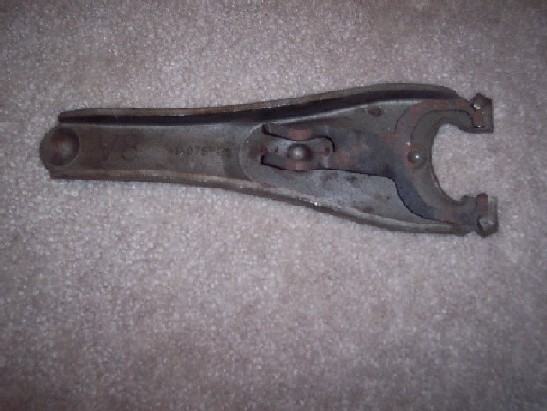

i just got my centerforce dual friction clutch assy and throwout bearing. the instructions say that the throwout bearing has to have a clip to hold the bearing on the arm. im pretty sure there isnt one on the arm. is there supposed to be or is this only w/ a centerforce bearing? its a V6 T5 btw

When I replaced the Original Fork Arm, there was no Clip on it. The New one I bought from Chevrolet had one on it. Before I replaced it, I could hear the Throwout Bearing vibrating through the consoul. After W/ the new fork = No Vibrations.
If you need a Pic of the Fork W/ the clip let me know.

if you could, that would be great

here
Attached Thumbnails question on throwout bearing-c-documents-settings-owner
