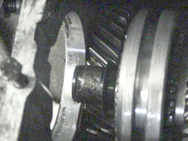

Well, if the clutch gear has broken-off teeth, the countergear (the one it meshes with) is obliterated too.
If there is ANY visible or otherwise detectable wear on the tip of the mainshaft, it's garbage. If you put it back together like that, it won't last; maybe not 5000 miles even, before it'll have to come back out.
Ahhhh, the case.... the reason the clutch gear failed that way, is because the case is bad. What happens is that the metal across the front of the case stretches, and allows the clutch gear and countergear to separate a bit, and misalign; and they don't live long after that starts up. If it leaked fluid out the front, then that's certain to be the problem. The front countergear bearing is supposed to be a drive fit in the hole. But when the case fatigues, the hole enlarges in an oval shape; the bearing spins; and the fluid leaks out.
Here's a pic of one that I have, where the bearing has visible wear from spinning and rubbing against the clutch gear bearing retainer.
