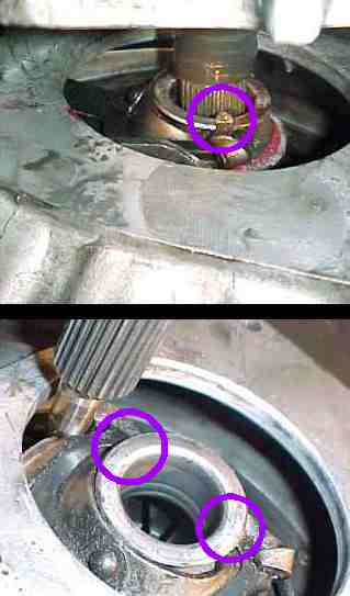

I just put a t-5 in my 89 camaro. it used to be an auto. when i put the clutch in, i replaced the slave and master cylenders. i bled the lines and i am still not getting the right pedel. it grabs ALL the way at the floor. am i missing a step. i bled out one bottle of fluid. any help would be great. Thanks

Looks like it's time for my famous fork/TOB pics. This REALLY should be a sticky....
Look at these pics. Which way did you put the throwout bearing on the fork?
One way is right. The other way will prevent the clutch from releasing.
I'll give you a hint: the top pic is the wrong way, and will create the failure you are experiencing, EVERY TIME.

now to see that i am going to have to pull the trans..Right? i cannot see that from moving the rubber fork boot. I think
