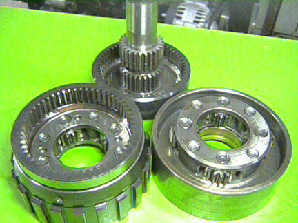

I was fortunate enough to find a straight-cut gearset out of a TH475 trans I found late last year, and in excellent condition:
I never bothered to check the ratio, since I always believed that the TH400 style trannies only came in a 2.48 ratio. From what I understand, the 475 trannys were only put in certain GM "P" chassis trucks (step vans, motorhomes, school buses). I'm not sure what mine came out of because it was half buried in the dirt in the middle of a bone yard. I only paid $100 for it since it had a broken case - apparently they didn't know what it really was.
