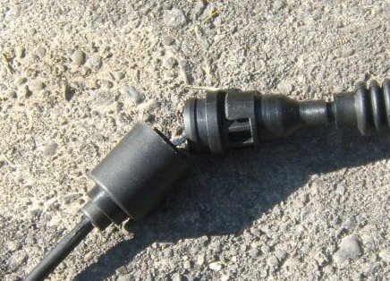

Check to make sure the cable sheath hasnt come loose from the housing. This will cause you to be able to get drive (well at least i could) but i couldnt get anything else, except nuetral. Ill try to find you a pic to better explain.

Something like this. It will be at the shifter, or the trans end. Possibly could be the nut has come loose and the cable needs adjusted

Get under your car on the drivers side, on the side of the tranny you'll see where the cable ends and shifts a black piece of metal. Try disconnecting the cable and shifting the piece with your hand. Getting into park takes a tiny bit extra force, but that way you know for sure you're in park. If the car rolls, take it to a mechanic, if not then you need a $50 cable.

It must have been inbetween neutral and drive because all of a sudden I lost power, I kept my foot on the gas trying to merge into traffic but it was not working..... the shifter said I was in D, so I just touched it to make sure and WHAMMO!!!! It was like a neutral drop close to 4000 rpm. It ruined the transmission so I replaced it with another one. I took it out for a test drive and had the same problem, thats when I found it was the cable, broken just like in the picture. I had to put a rock under my wheel to block it and crawl under the car to shift it from park to drive by hand.
