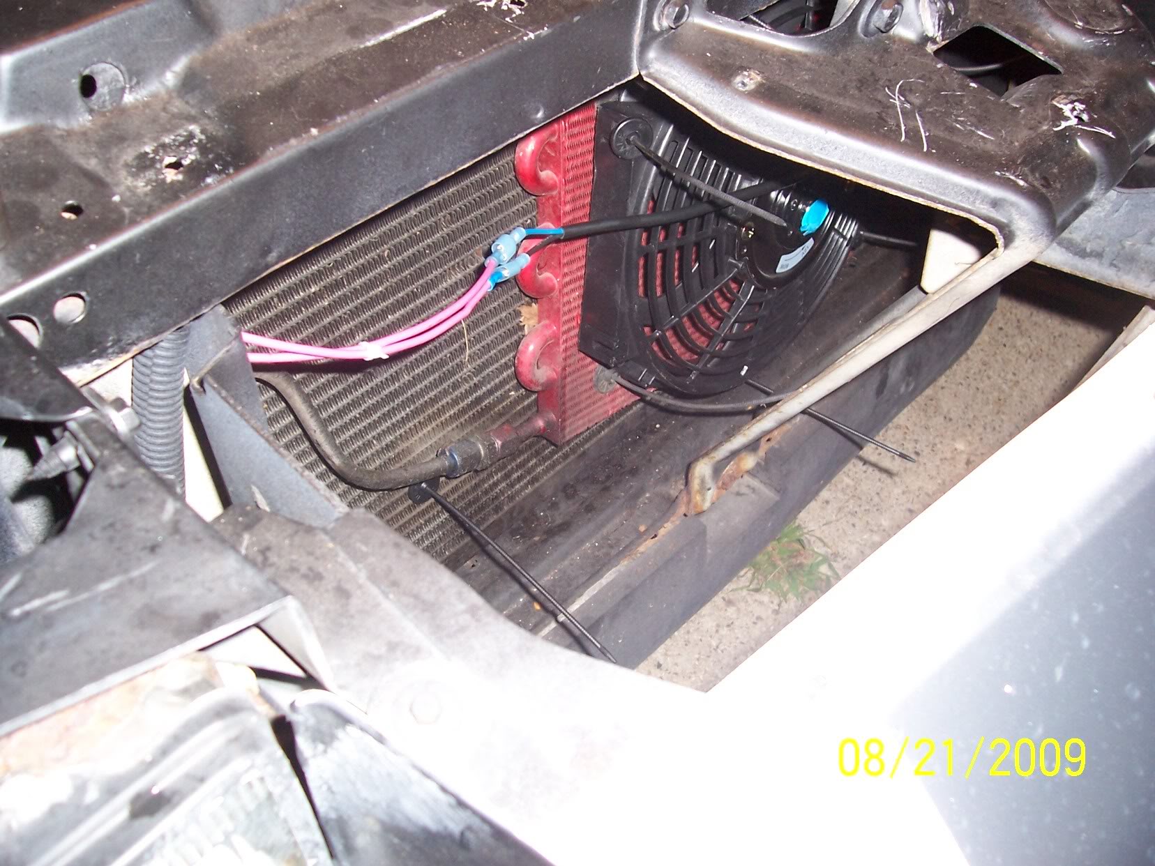

Gauge, cooler, and fan are where it's at!
