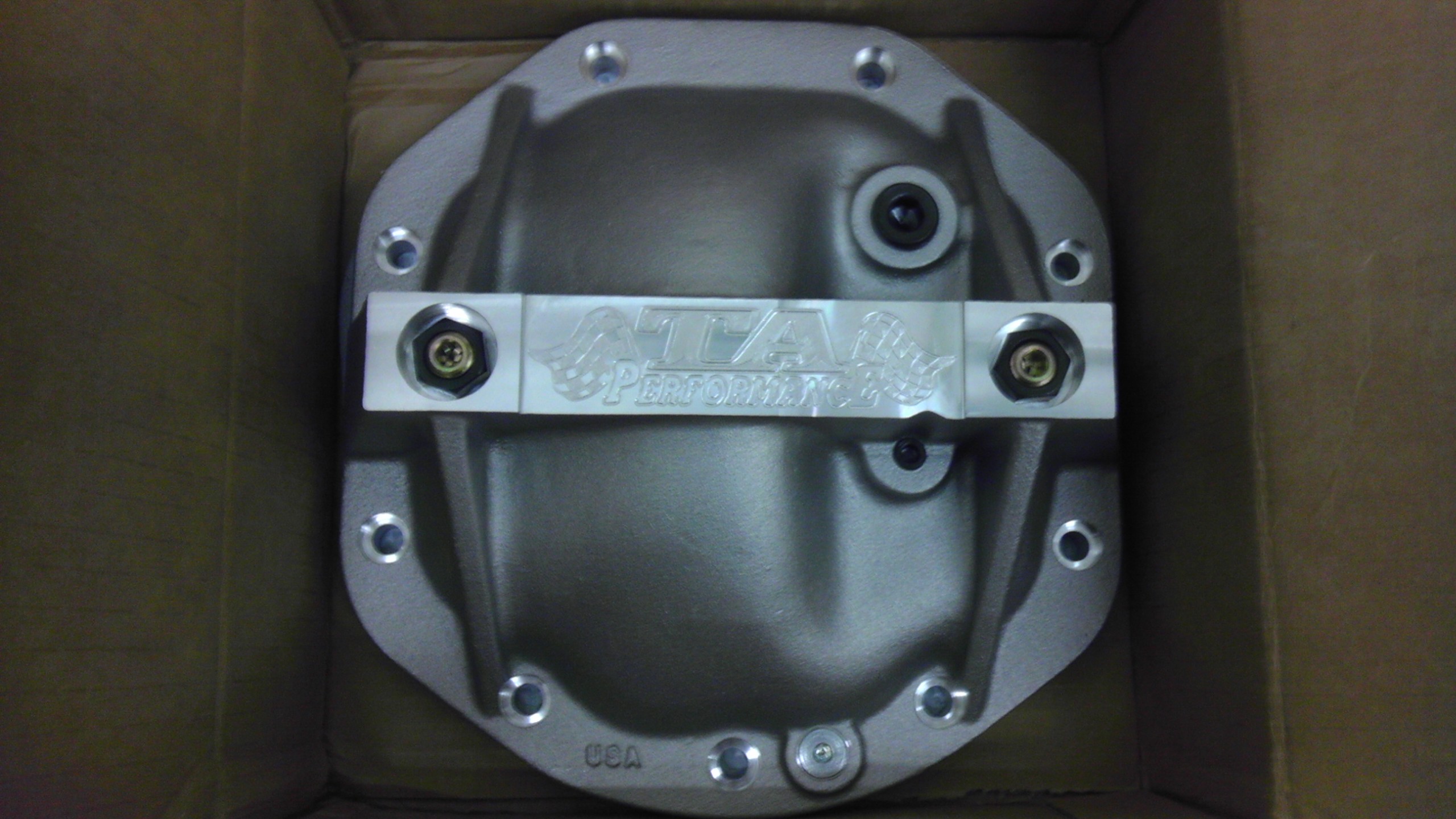

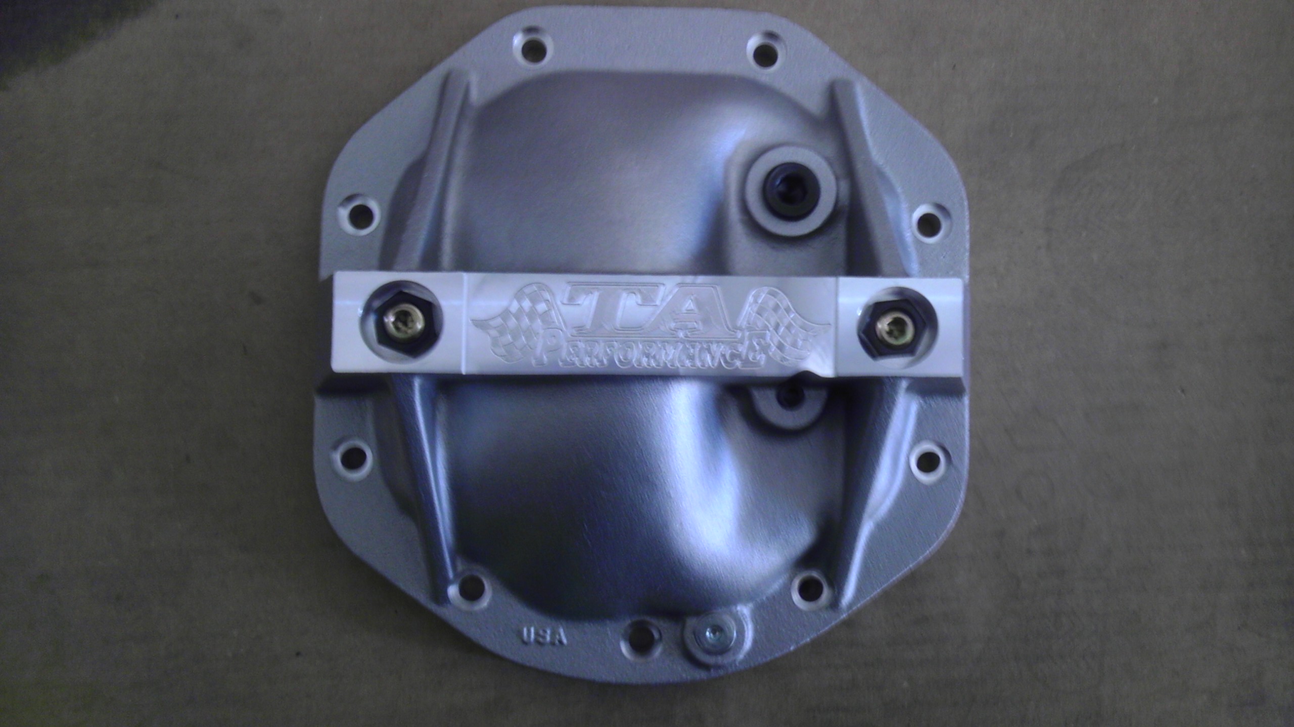

Here is a shot of My T/A Performance Rear End Girdle. Enjoy...
The ironic part is that I had originally purchased a Perfect Launch Differential Cover in a 10 Bolt Pattern. Only to realize that it didn't fit...
Turns out I have a 9 Bolt Rear End.
