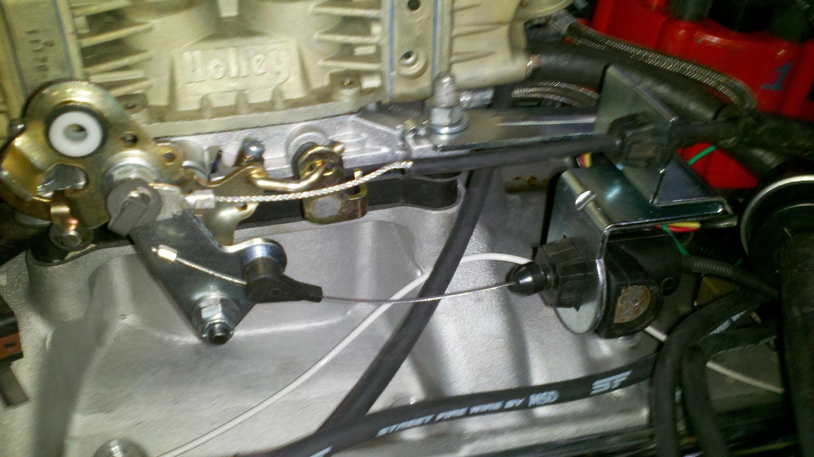

ok ran into a problem, the tv cable thats on the car is too long? i was able to slide the cable using the d button on the side but it wont slide foward any more. im not sure what options i have at this point?

pics

Old Apr 27, 2012 | 06:24 PM
Posts: 27,918
Likes: 2,448
Re: tv cable
Cable's prolly fine.
Problem there is the bracket... try a stock one.

Re: tv cable
well damn, i just spent 75 bucks for those two brackets, am i able to cut it and reweld it further back to get the right length?

do i need one for a 350 or 305?
Yes. I's stay away from 6-cyl stuff.
I'd suggest getting the cable for a carbed one; although I don't think it's going to matter as long as that T-350 kickdown bracket is on there instead of a 700 TV cable bracket.
A stock bracket will be too far forward, the primary throttle shaft is farther back on a Holley than on a Qjet. It'll need a Holley-and-700R4-specific bracket.
Sure that's not a TPI cable?
i listed the part numbers for the brackets, they are holley/700r4 specific.
i ordered the 305 tbi cable and ill have it in the morning, ill let you all know how that goes

i got the new tv cable installed and it was the right one this time. it fits great, but it still shifts itslef out of first gear.
