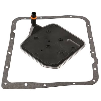

Well after taking it back to school and pulling the pan off and taking the filter out, I found two O-rings that stayed behind where the neck of the filter goes up into. I removed one and put it all together, it shifts a little sooner, but still not soon enough. Hopefully someone knows this off the top of their head: The direct-fit filter with an orange type of O-ring (about an inch tall), does it require the use of the regular small black O-ring? Just my thoughts are, after taking one out of it and I get shifts sooner, maybe the other one is still extra and allowing fluid to leak giving me less pressure. But I dont feel like taking it all apart just to take that O-ring out if it really is supposed to be there.
Old Feb 18, 2013 | 10:43 PM
morgsie's Avatar
Joined: Feb 2008
Posts: 454
Re: hard shift into overdrive, no upshifting
The o-ring that is still in there is probably the old one. It sounds like when you removed the old filter you didn't remove the o-ring, then installed the new filter and o-ring. I would suggest installing a new o-ring. Also, the weird shifting/operation could be from the synthetic fluid.

That is exactly what happened, is I never bothered to look up in there to see any old o-rings in there, and slapped in the new filter. But what I'm trying to find out, is am I supposed to be getting rid of both of those small black O-rings, and use just what comes already on the new filter.
http://static.summitracing.com/globa...-ft1074a_w.jpg
That link is to the filter I ordered, and does not appear to have the small black o-ring, just the orange piece that I was talking about in my previous post. Just need to know if anyone else has changed their filters in a 700R4 and what all was used on the neck of the filter.

all you need is the orange piece on the filter, that is your filter seal. anything else isn't needed and may hinder the filter seal from doing it's job.
