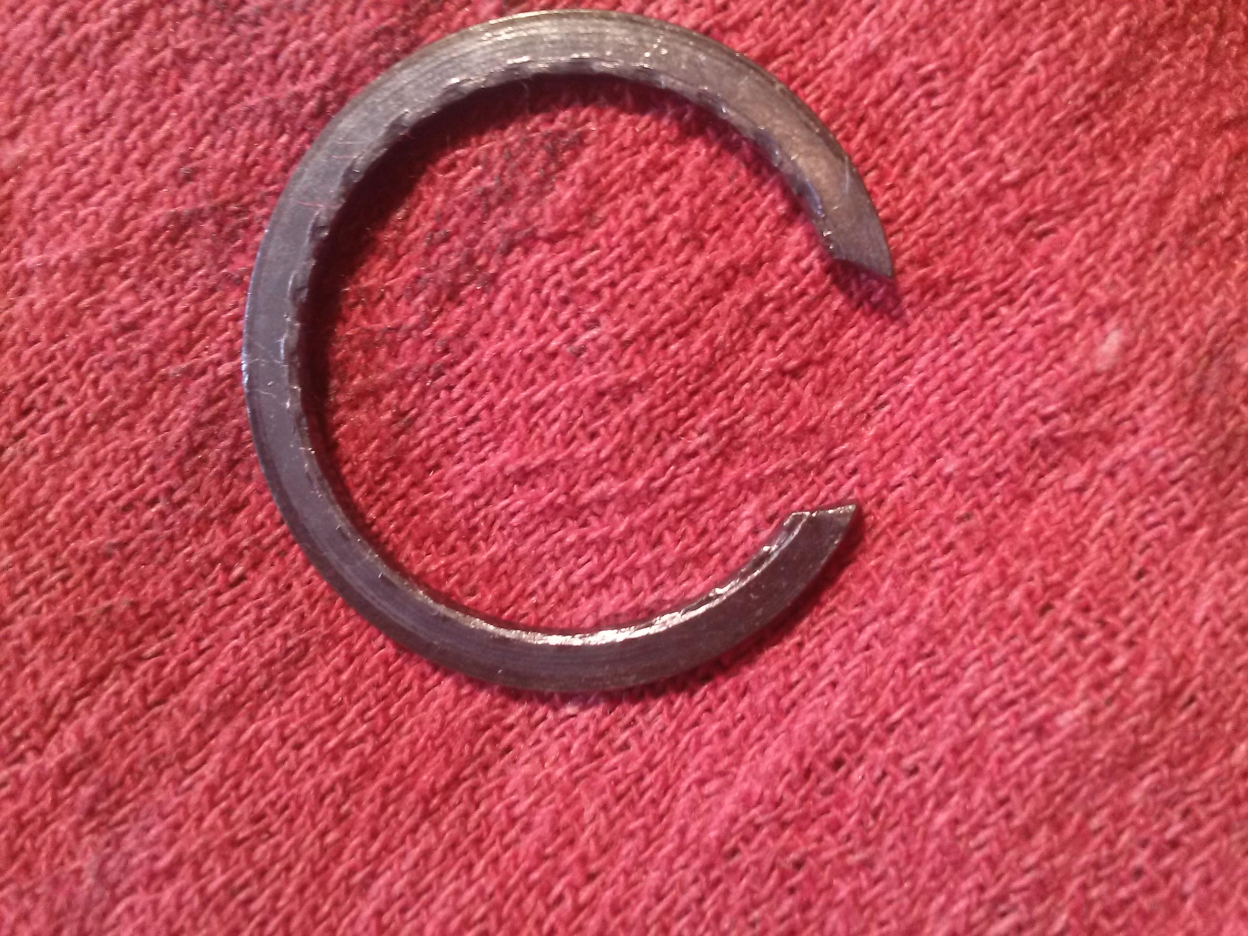

ok finally back with pics... no sign of that super Loctite, thinking it melted away. as you can see in the pics 5th gear blows past the snap ring. wtf. all I can say how does 5th gear keep going past the snap ring(and chews it up). well this time I added a 2nd snap ring in the groove past the 1st groove, and now I cant shift into 5th. well I can if I slam it and force it, but then I have to pull hard (and usally into 4th) to get out of 5th gear. im thinking its the extra snap ring. or I messed up the 5th gear shift rod somehow. thoughts?

Yes, I meant the picture as camaraderie; how many people tear down their own manual trans. to fix them?
The mainshaft gear is getting shoved off off somehow. A vibration (perhaps in the countershaft speed gear) would do it. Troubleshooting that could be a PITA; I'd drop a line to someone who is all about the T5.
The stuff I use would go to powder easily if ground up. If 100% intact, it dries to a clear sheet.
Potential problems are the groove in the mainshaft smoothing over (and allowing the ring to walk out) but a normal functional gear relationship and gear-shaft relationship shouldn't walk the driven gear off that quickly. Something is worn. A similar thing happens when the T56 5-6 mainshaft cluster gear gets loose. It will (eventually) walk the reverse synchro right through the lock-ring.
Time to compare your parts to newparts and replace. Or maybe a core for parts.

thanks for the input. im guessing the snap ring groove is smooth but before I took the trans apart the first time 5th stayed on, but had a good amount of free play in the shafts. now that I rebuilt it, and not nearly as much free play (all nice and tight) 5th gear seems to do its own thing. im about to start a new, very good career so im just gona be done with it. in a few months (hopefully) ill be saying hello to a new ls1 and t-56 sell your this t-5 cheap so you can have the headache
