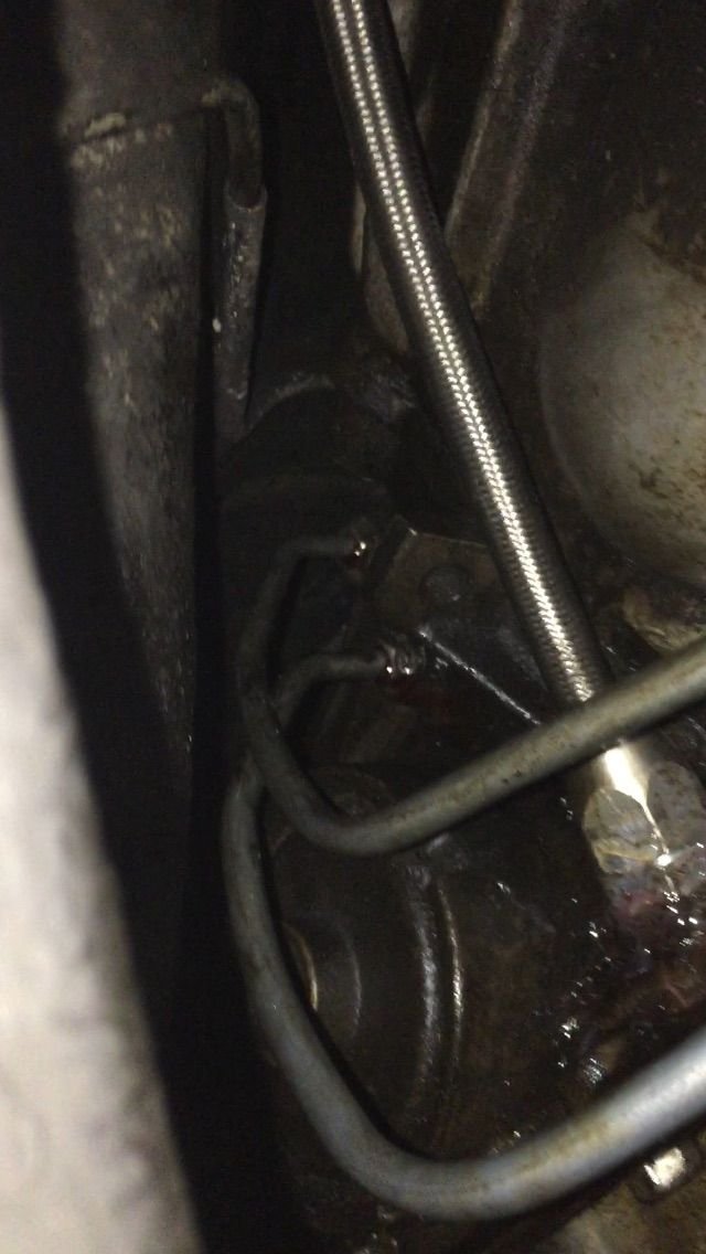

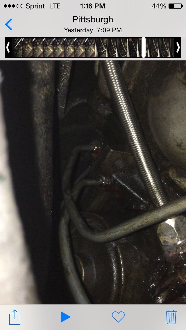

Working with a 4l60e trans with stock cooler lines and stock rad. Now I removed the 4l60e quick disconnect fittings and screwed in the stock line fittings into the trans, seen someone here say that works. When the car is running I'm getting a leak at the lines but the fittings are tight, lines have a lot of in and out play also. Do I need to take these fittings out and do a better job or holding the lines straight and tightening the fittings back down to hold lines in place? Or am I missing a extra part? Should there be a adapter that screws in trans them line fitting to that? Or do I have it installed wrong? Please help!

If you're sure they're both leaking remove the top line from the transmission. Check the flare on the line in front of the fitting that you have just removed. Make sure it is not split or cracked... When these are installed they don't need to have a lot torque on the tightening. Just snug down.

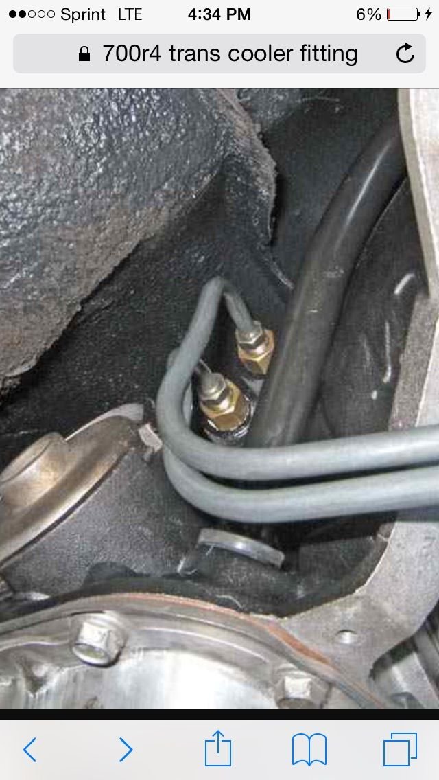

Great write up on the tools to use I've been in my machine shop thinking of stuff to make this easy without having to drop tranny that's perfect. I will get line off and check flare but also while researching I came across pics of the 700r4 and those have adapters that screwed into trans case then line fittings screws to that, shouldn't mine be the same? I'm thinking me screwing my line fittings right to case is my issue. The flare isn't tightening down allowing a lot of line play and fluid pushing through. It should be like in the picture right or does it not matter?
The flared lines need a matching, opposite flare in order to seal. That's the purpose of the brass adapters shown in your photo.
I can't recall but I think the threads in the transmission where the adapters are screwed into are pipe threads. Different from the threads on the line nuts. if this is true, the threads in the transmission case might be FUBAR now.
