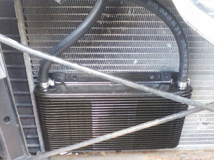

Where you mount the cooler is important. You want as much airflow as you can get so most mount there's somewhere in front of the radiator/condenser. Also where it's placed in the transmission line plays a roll. I installed mine after the stock cooler. I simply thought the larger cooler would do most of the work then the smaller would finish the job.
Here's the Super cooler that been suggested and Summit Racing is an exhalent place buy from.
Link = http://www.summitracing.com/parts/bm...FQVbfgodxzcDJw

Originally Posted by Ron U.S.M.C.

I will probably purchase the super cooler thanks everyone.
Now that I'm thinking about it, I think the video game Gta5 is has the camaro/firebird with the option to have the tranny cooler mounted outside the vehicle. Which is interesting.
Do you fill it with coolant like a mini radiator?
Thanks everyone. all this information is helpful.
