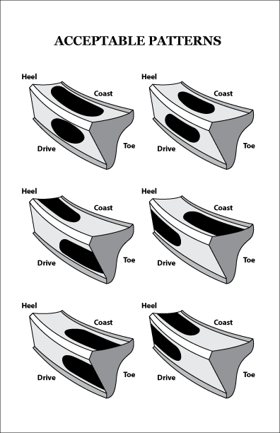

Re: Gear pattern (used gears)
These should help you decide.
Attached Thumbnails Gear pattern (used gears)-acceptable.gif   Gear pattern (used gears)-too-deep.gif   Gear pattern (used gears)-too-shallow.gif   Gear pattern (used gears)-toothterms-e1315948831207.gif
