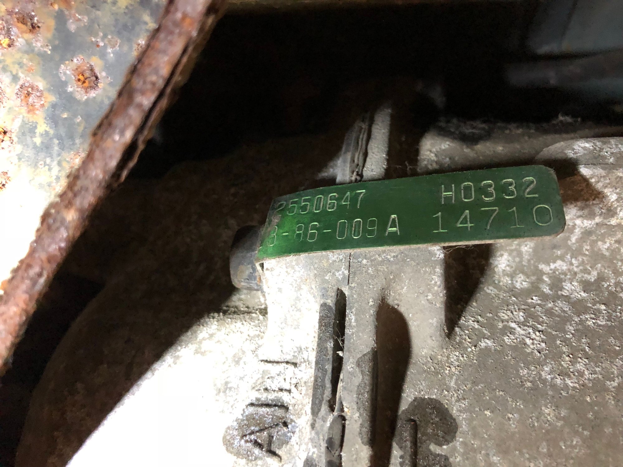

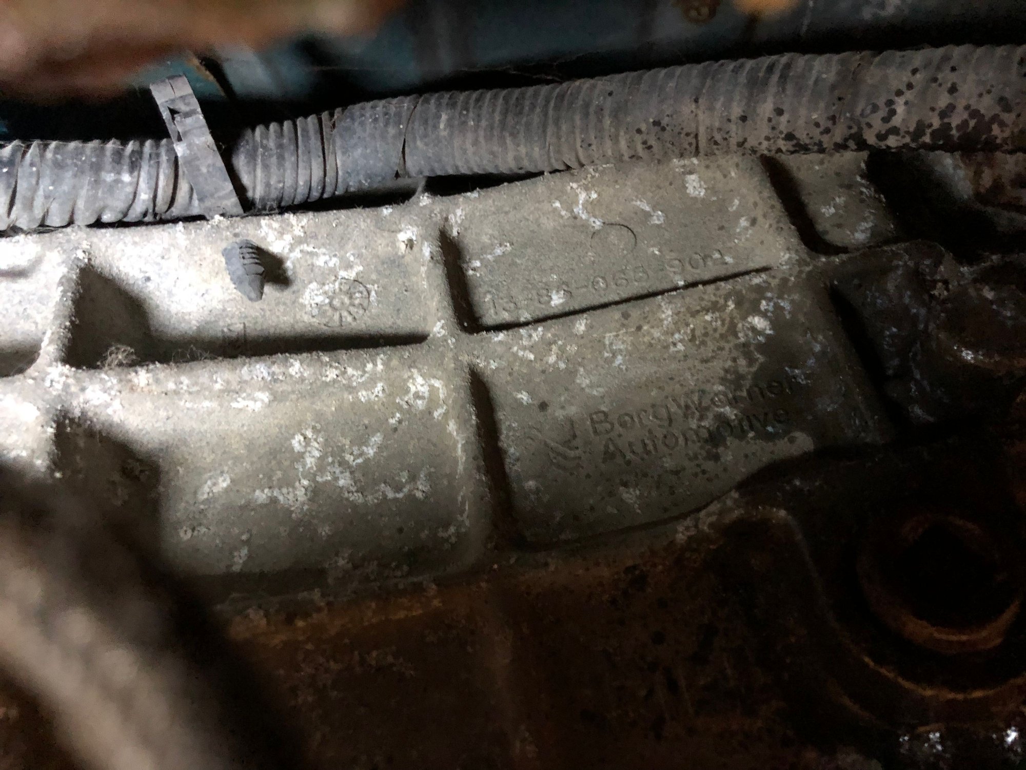

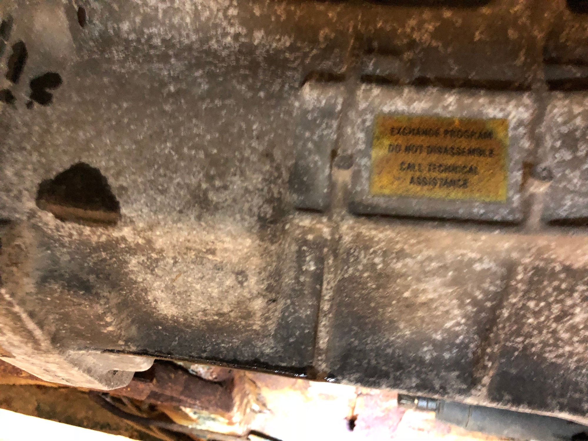

Just a thought as I was draining the tranny fluid into a clean container from the parts car.. would it be worth sending the oil away to have it analyzed for $30 bucks? Not knowing what condition the tranny is in I’m looking for clues without spending cash for a full rebuild if it doesn’t need it.
I noticed that some of the factory tags looked like they had black paint on them I was wondering if maybe it has been rebuilt already. Doesn’t look that fresh though, I can’t see any sealant or anything..

Actually, that looks like a virgin 94-95 T56, which you expected, eh?
Lube analysis isn't going to tell you much. The blocker rings are fiber those years (replacements were carbon starting late 90s) and the 2nd gear synchronization teeth are weak those years. Granted, you could drop $ to be told there is fiber and metal in the fluid, but that won't change whether it drives fine, which it may. Armchair rebuild says new pads, blocker rings, new 2nd gear, maybe bearings, maybe not, the 5-6 gear fit on the mainshaft may need welded up, and upgraded keys and pads aren't a bad idea.
There is RTV above the green service tag. The black spots in the other pic, maybe oil, maybe undercoating?
