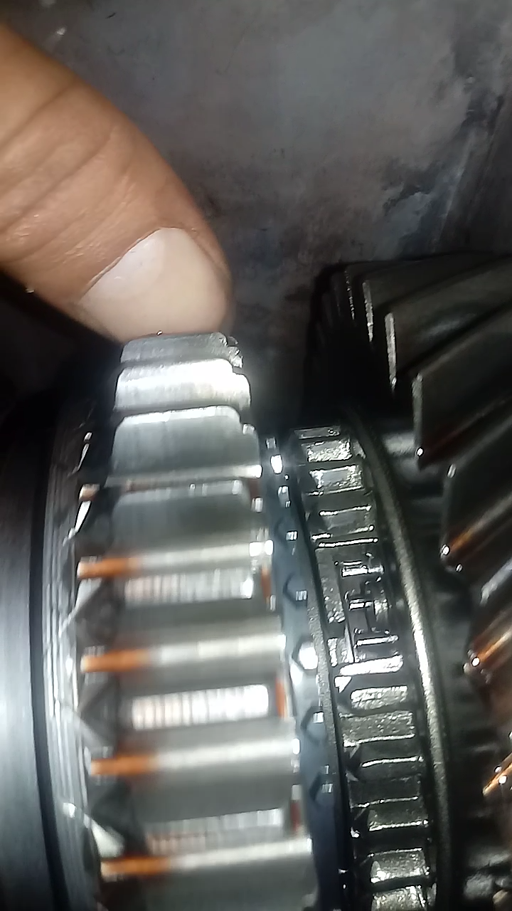

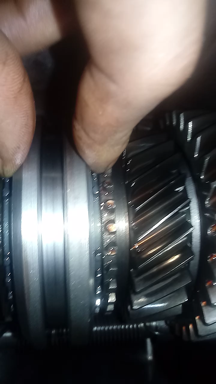

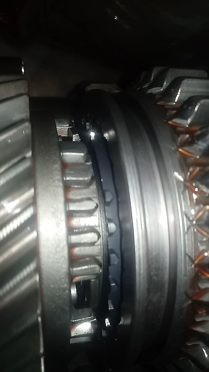

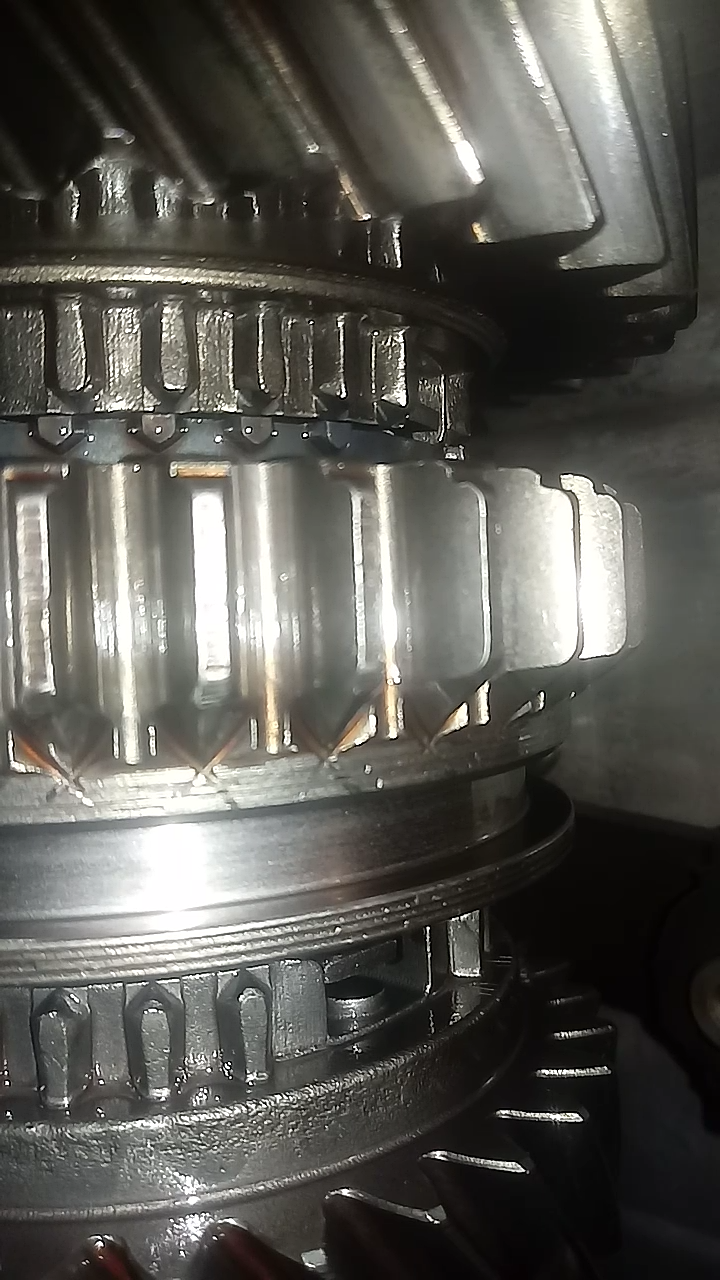

Finally found a v6 T5 and I'm getting ready for my auto to manual swap, but not really sure what shape it's in. Heres a few pics. If it's bad I'm gonna be learning how to rebuild the T5! Looks easy but if it's not broken why fix. Do I have to tear it down to be sure?

Doesn't look too bad. What I see, I'd run. Particularly, reverse isn't all ate up from a driver that didn't know to put it in a forward gear before reverse, crashing and grinding it every time, and filling the fluid with metal chips.
I'd recommend leaving it alone and running it. Devote your attention to the clutch. Make sure EVERY DETAIL about that is right. The vast majority of "transmission problems" are REALLY clutch problems. And a bad clutch, that doesn't release properly, will tear up all the shifting parts of a transmission.

Cool thanks for the tip Sofa, gonna run it as it sits. V6 t5 owners what clutch would you recommend?

I agree, looks to be in good shape. Sure looks like a world class version too. Good score! Your putting it behind a v6?
