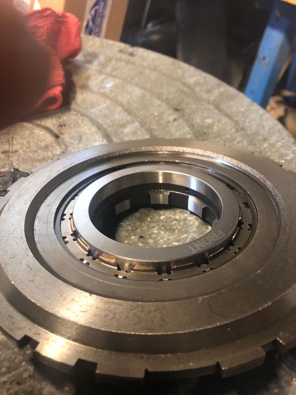

Hello, I’m having a hard time inserting the outer race into the low reverse roller clutch. I’m using a BorgWarner brand here is some pics of my old and the new BorgWarner. I’m also using a Sonnax SmartShell

Put a slight bevel on the inner race where it goes into the roller clutch. Sonnax does not do this on all of them. I have run into this myself. Look at the old inner race to see what I am talking about. This will make it easy to install.

I test fitted the Sonnax race into my old roller clutch and it fits nicely. I’m thinking that the BorgWarner unit is crap. I thought it was good because it was made in USA, there has got to be a way to wiggle it into place. I bought both the forward sprag race and the low reverse roller clutch as a set. I had no problem with forward sprag.

Did you read my post. Of course it will fit the older roller, it has wear!!!

Oh I’m sorry you are right I do see the bevel. Maybe sand the edges with like 320 and just stay away from the small bearing zone

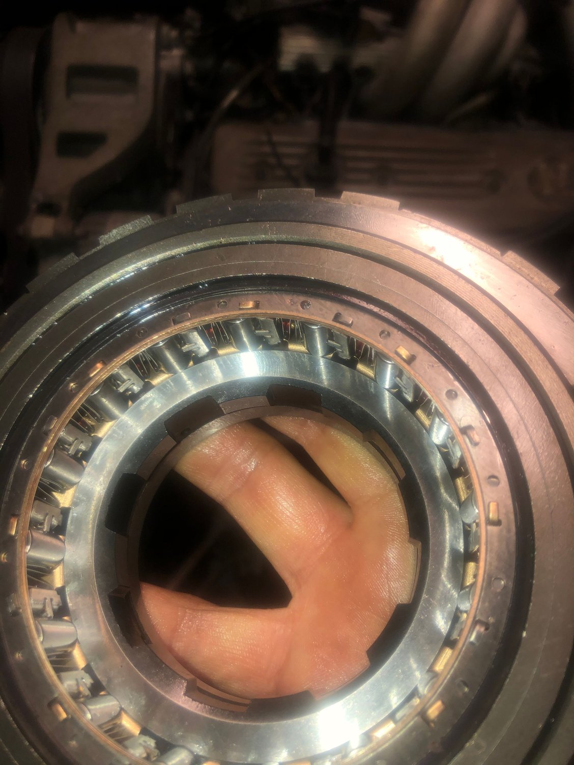

Hello everyone I think I figured it out here are some pics of it complete. I had to push,twist and fiddle with some of the bearings but it went in without sanding the race edges . Sorry for being annoying to everyone on this fourm so far. I’m just under a lot of stress lately with work and all and it’s almost summer and I really miss my car. You guys in sunny California are so lucky with the weather. I don’t know these days I’m just not as sharp and patient with cars like when I was a teenager. I’ve never really owned any new cars and have done everything myself when it came to car repairs, including family and friends. Sorry for the rant!!!
