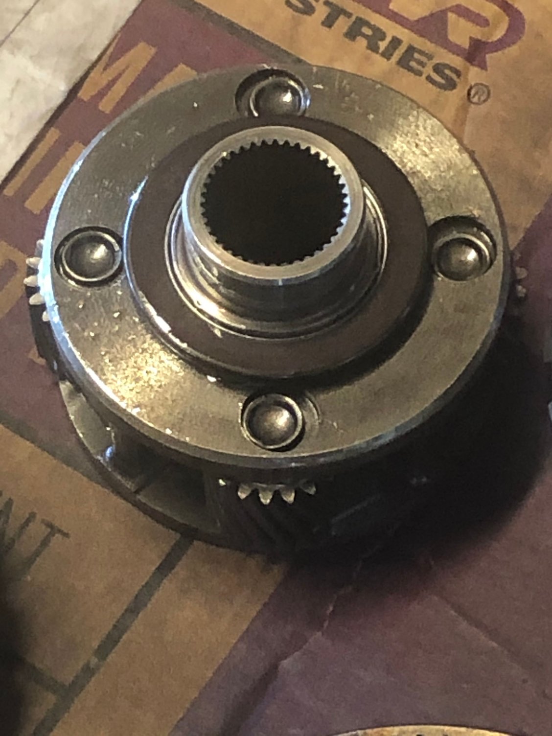

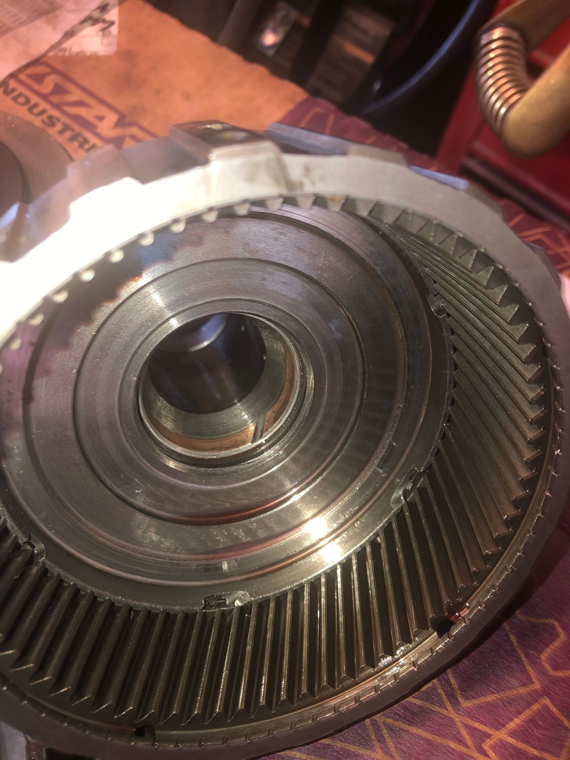

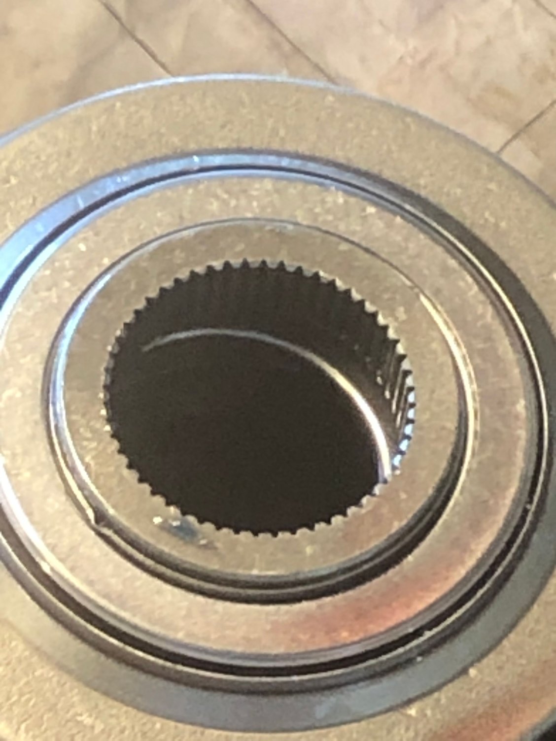

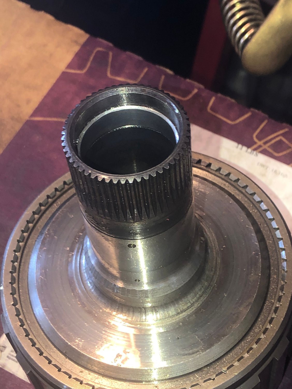

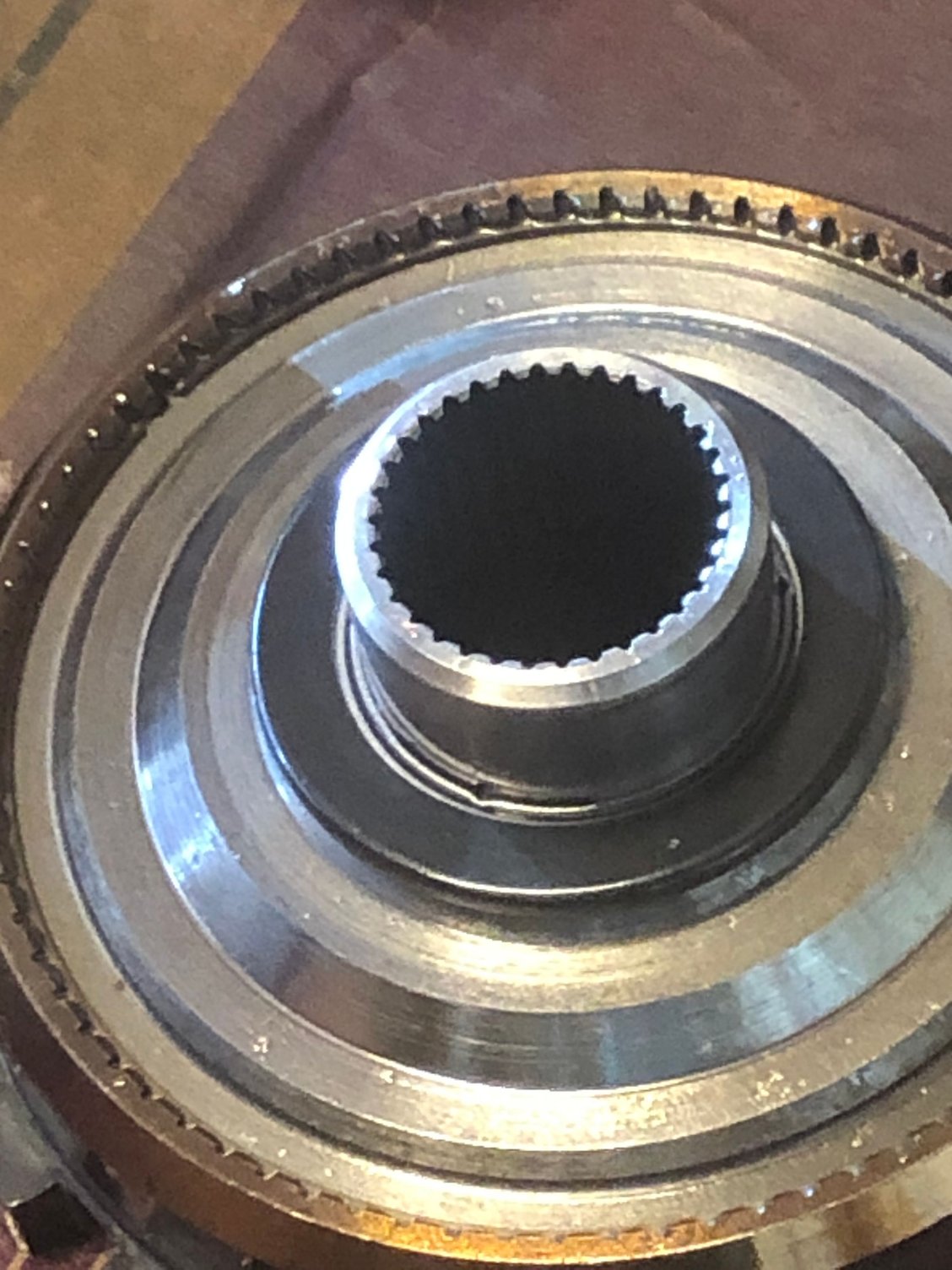

Hello everyone, I’m starting to load the case with the geartrain stuff. Are my Torrington bearings on right and the bushings at the correct depth. I made a lot of beginner mistakes by not paying attention to the details when I dissembled. Here are some pics

Look in your ATSG manual, Figure 178. It shows the orientation of all the thrust bearings.
The bushing installation depths look OK to me. As long as what ever rides inside the bushing is fully supported you should be fine.
Edit: The attached page from the Hydra-Matic Tech Guide is the same as that from the 700R4 manual, just better scan quality.
