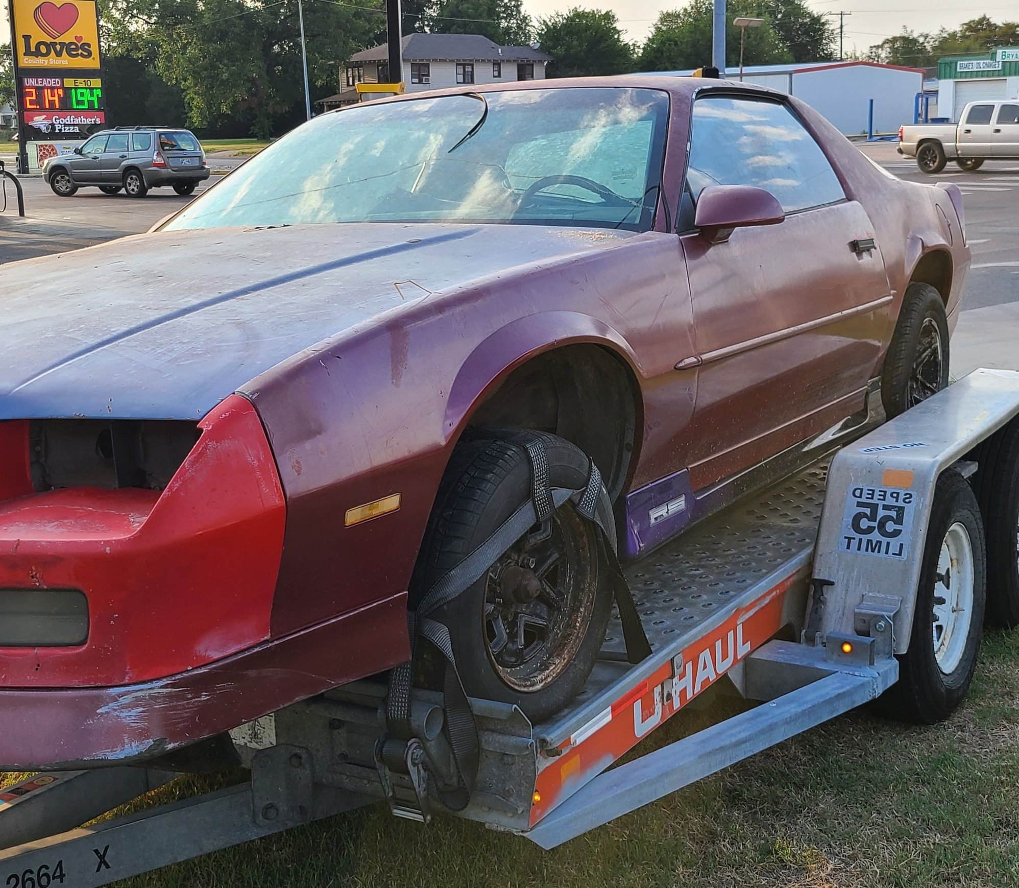

Im new to the car scene. So im rebuilding an 88 IROC Z and the guy i bought the car from said I can just take the bell housing from a truck and use that for a transmission... I have no idea what that means. The cars in decent condition all its missing is engine and transmission and I bought it for $550. I'm just trying to
figure out if I just need to buy a 700R4 or not.
