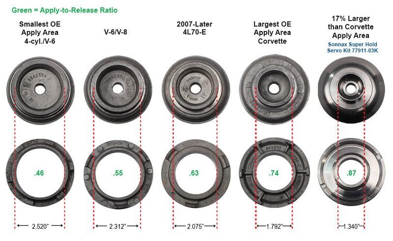

go with the sonnax 2nd gear servo it has more area then the corvette servo and still uses the cushion spring unlike the superior super servo

Thanks for the info, I’m not looking for something really extreme just a little more than stock to give it a quicker 1-2 shift but the sonnax looks like a quality part, lot of choices for this and I want a quality servo. I saw global transmission had one that is drop in ready to go but do not know much about their quality

you dont need all that the rest is the stock stuff cover, 4th servo, cushion spring, return spring ect. that you already have, the piston is the only difference and what makes it shift faster and harder
https://www.ebay.com/itm/4L60E-700R4...sAAOSwsR5fhy0X
this servo has the most apply area and shifts the fastest and hardest but a cushion spring cant be used and the shift is very harsh if the separator plate holes arent made smaller than stock

Until the 4L60E, the Corvette servo was only in Corvettes. With the 4L60E, the Corvette servos were available in Hi-performance TA's & SS Camaros.The newer Superior Super Servo uses the steel cover and cushion spring. I don't know if the old sty;le is still being made by them. They are very similar to the Sonnax servo, without the dual apply sealing rings. The reason that the Corvette came about, was as horsepower improved, the 2-3 shift started having a 2-3 shift flare at WOT. The Corvette servo helped solve this problem, along with the .471" main boost valve and sometimes the .296" intermediate/reverse boost valve, available in the Corvette. The .296" intermediate/reverse boost valve firms up the 1-2 manual shift at all throttle openings. Another benefit of the Corvette servo, was improved 3-4 clutch life. I use these in the vast majority of my builds. Once I get over 675 FWHP, I use the Sonnax Servo, or the later Superior Super Servo. If below 675 FWHP, and the driver, drives very aggressively. I will add the larger servo.

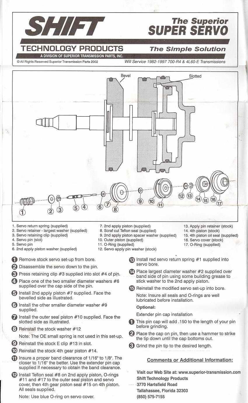

for the superior servo where do i install the cushion spring?
imo they are not similar to sonnax the superior has the largest apply area and the shifts and downshift clunks are the harshest
