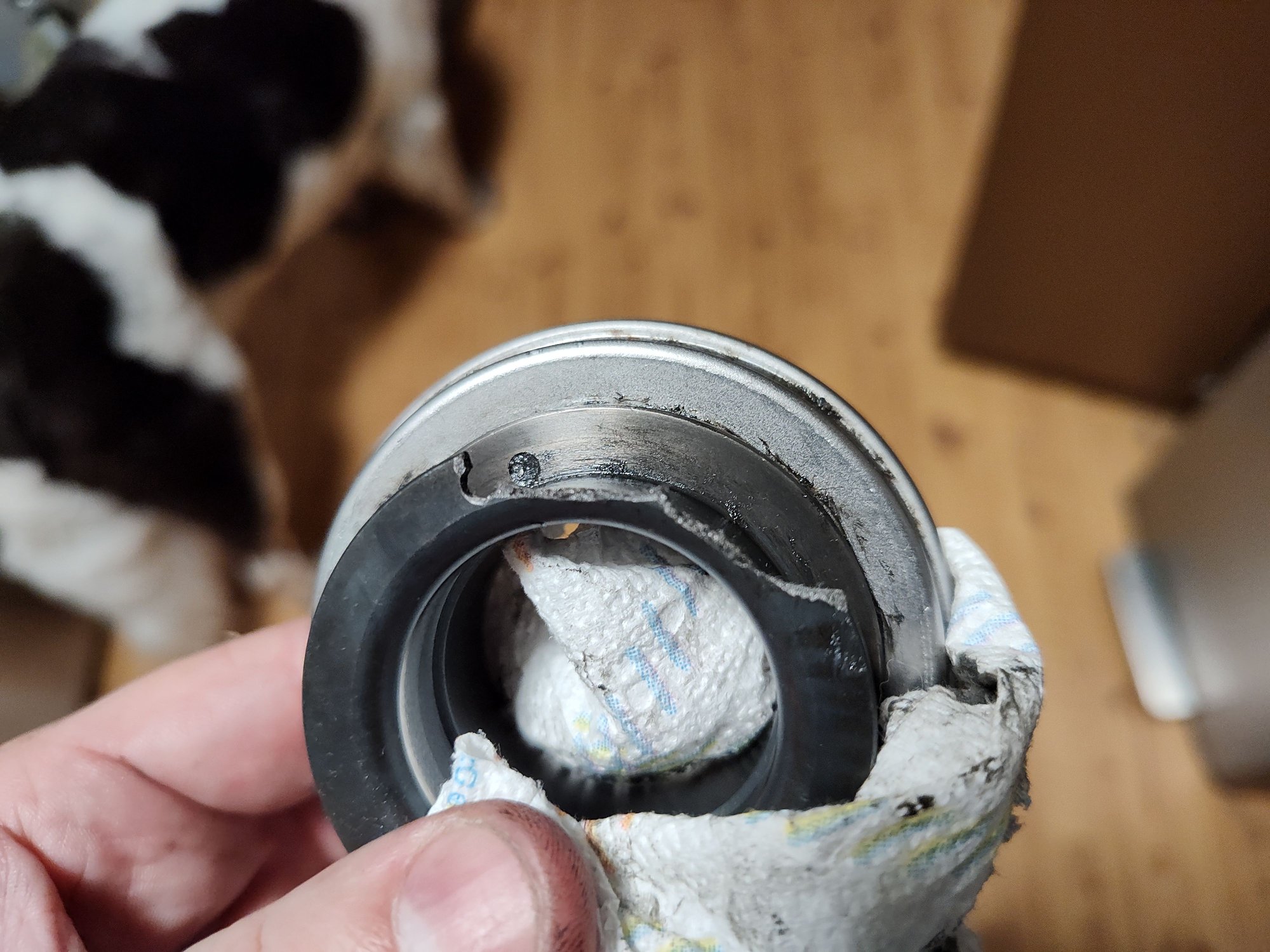

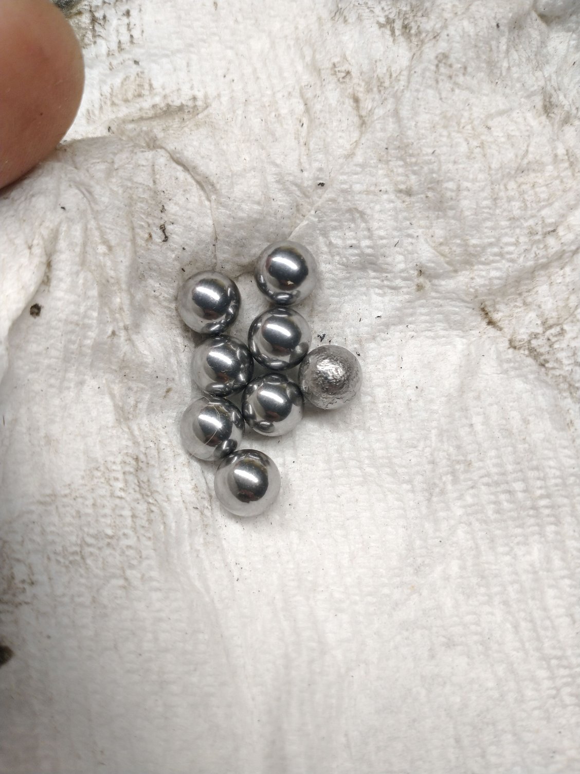

Took apart the bearing looks like one of the ***** started to fall

Trying the center Force next. Here is what happened with the Hays from Holley

One thing i noticed is centerforce may use a generic bearing that looks identical to other brands; as many brands. It is indicated by comparing the stamped multidigit model number in various photos. All look identical in stamping placement and font.
Not saying it is bad, or even correct But same bearing may be priced better elsewhere.

Yup looked like it had a national bearing PN on it
