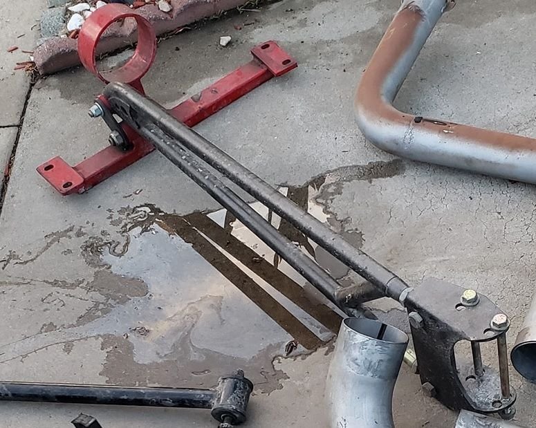

hey guys i got this torque arm as part of a package deal when i bought a 12 bolt. only thing was it was on a 4th gen. does anyone know if itll work or i can make it work on a 3rd gen or will i have to get a 3rd gen one?
Thanks in advance
sorry this is the only pic i have of it at the moment.

Torque arms that go to factory mount are interchangeable but yours is not. 4th gen trans crossmember is different. And since your torque arm is mounted to the trans cross member it's kind of a package deal. You might make it work if you made yourself a new transmember with mount.

well this one doesnt go all the way to the trans crossmember. so it seems like technically i could just bolt it through the floor and add some big plates under the carpet to strengthen it up.
heres a pic of how it was on the previous 4th gen.
