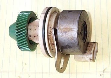

These Model-Years then use the bastardized VSS/ Electric-Speedometer that still has the Plastic-Gears instead of a Reluctor.
Thanks again.
For anyone that has not seen these before...
This is a "in-between-system" that came after Cable-Driven Speedometers, but before the Output-Shafts had a Reluctor that is read by a Magnetic-Pickup.
