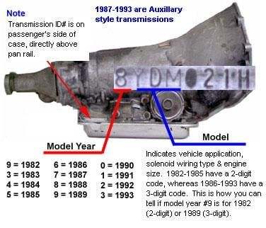

What area of the Transmission did you scrape clean... that removed the Broadcast Code?
THM700-R4 Units will normally have the Serial Number/ Broadcast Code Stamped into the Oil-Pan Rail:

To be clear, I did not remove the code, I scraped clean the area of junk at the pan rail to FIND the code I wrote. There are no other codes or VIN-derivatives stamped into my 700 now that I have completely cleaned it. I misunderstood and thought there was.
