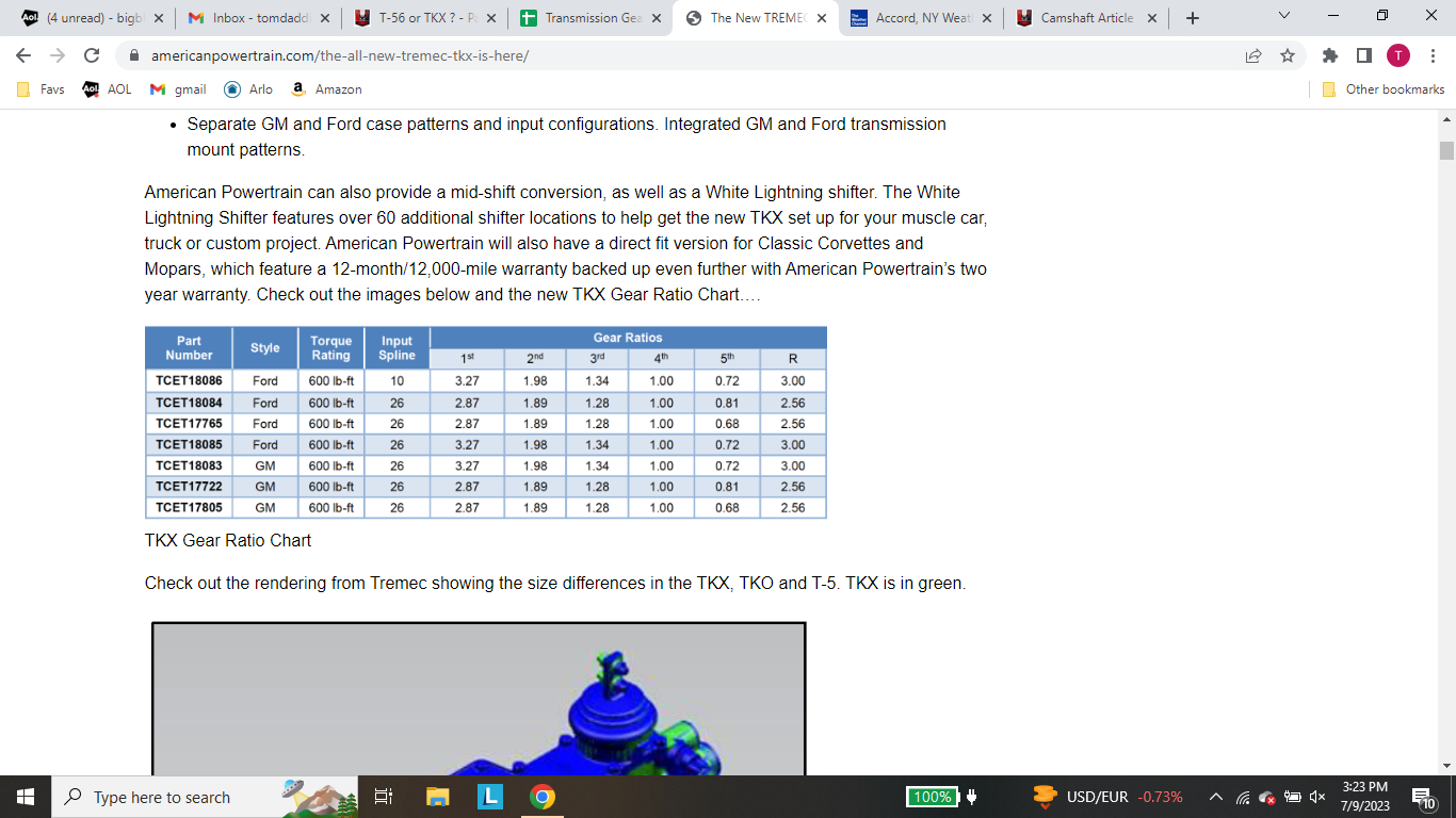

Ever have one of those days where for whatever reason you consistently screw up one littel thing? Yeah, this is one of those days.
I fixed the TKX missing first gear stuff. When I added them I deleted one two many columns so 5th gear became the reverse gear.
But its all good now, and I set it to your settings, 18085 TKX, 3.73s, and 245/50/16's.
So, once you make a copy, you don't have to change anything. You can delete the older copies you made. Since I use this sheet for multiple cars, so i'm in there every month switching options around to get the Gear vs MPH by RPM charts.

QwkTrip
Thanks for your time
18085 is the ford version
17805 is the GM version

The 3.27 1st gear is meant for the majority of cars that pretty much just cruise and go to shows. It's got a more aggressive 1st gear to help a car with freeway gears get moving off the line. The compromise is a big 39% spread on the 1-2 shift that drops the engine too far for performance driving and [most people don't realize] also contributes to tire spin going into 2nd gear. Car will perform better and tires hook up easier at full boogie with a high rpm, quick, and tight shift.
Between the two other options with 2.87 1st gear, each gear change is,
1-2.....2-3.....3-4.....4-5
34%...32%...22%...19%
34%...32%...22%...32%
19% overdrive is too tight in my opinion and will leave you wishing for another gear, especially considering it's only a 0.81 ratio. That's not even as much overdrive as a T56 5th gear (0.74). You'll be putting pointless wear on your engine revving it waaaaay higher than you want.
32% overdrive is a huge drop from 4th gear and is the same spread as the 5-6 shift of a T56, but not as deep a final ratio. I think it's going to be really annoying and create a "no-man's land" on 55 mph highways because 4th gear will be too high rpm, but 5th will drop ridiculously low. It's just begging for a 6th gear in between....
This is why I recommend and think you'll be happier with a T56 6-speed. Not only do you get tighter overdrive spreads that are more practical, but the final drive (0.50) is lower than any of the TKX transmissions giving you improved interstate cruising. Basically 5th gear will end up being your highway gear (55 mph), and 6th gear will end up being your high speed interstate gear.
If the TKX has a 6-speed option then maybe post up those gear choices so we can walk through those too.
TKX does not, but it's just a hop-skip to the Magnum-F, which is is a T56 case, but internally it's basically a TR6060. Good to 700lb/ft and 8500rpm shifts.
The Magnum-F is what's going into my GTA, because whatever engine I build next will rev to at least 7500rpm. I want to build an engine that makes power all the way up to 8000rpm if I can, but 7500rpm is a more realistic number.

After a lot of time working on house projects I decided, after many conversations with Jody from Jody's Transmissions to go with the TKX.
TKX TCET17805 GM 600lb-ft 26 Spline 2.87- 1.89-1.28-1.00-0.68
He put together a kit using his experience and vast knowledge of what works.
Jody is great to talk to and provides exceptional customer service.
I will start new treads going forward with questions that arise.
Thanks for all the time and advice
