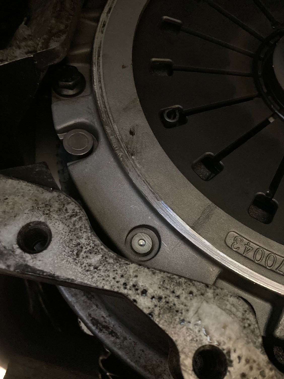

So, we pulled transmission last night.
When clutch is depressed, the clutch fork is rubbing the edge of the pressure plate.

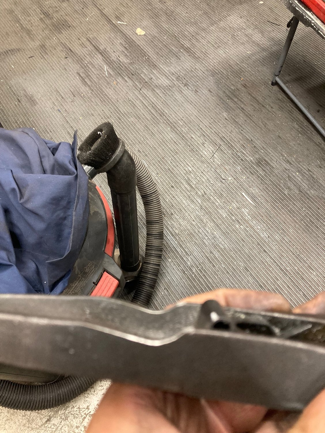

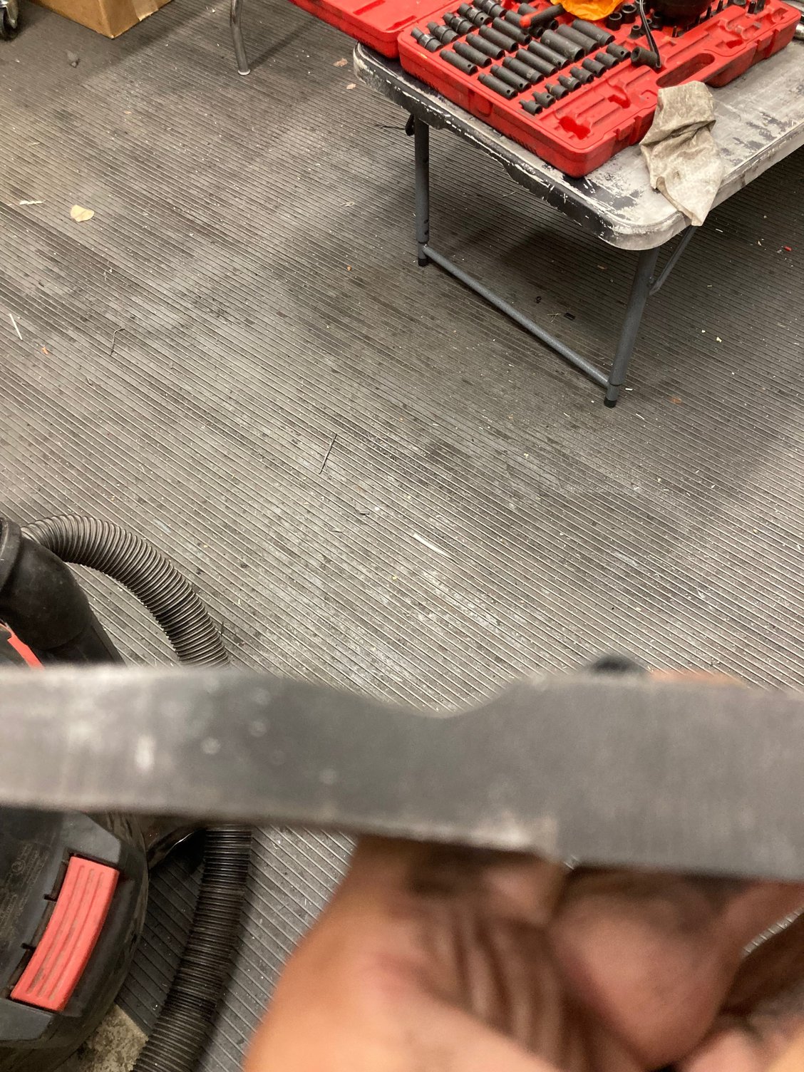

OK, problem is solved. When we pulled the transmission, we observed that the clutch fork was rubbing the edge of the pressure plate (see pic)
We could see the rub marked on the edges of the clutch fork. So went to my buddy who is a machinist and he milled out the edge of the clutch for to clearance where the fork was rubbing the pressure plate. The form material was hardened steel so it was good to have access to the milling machin. We took this muchmaterial off (see pics)
Problem solved. We reassembled and the clutch operates properly with no rubbing. Parts installed on car are as follows
