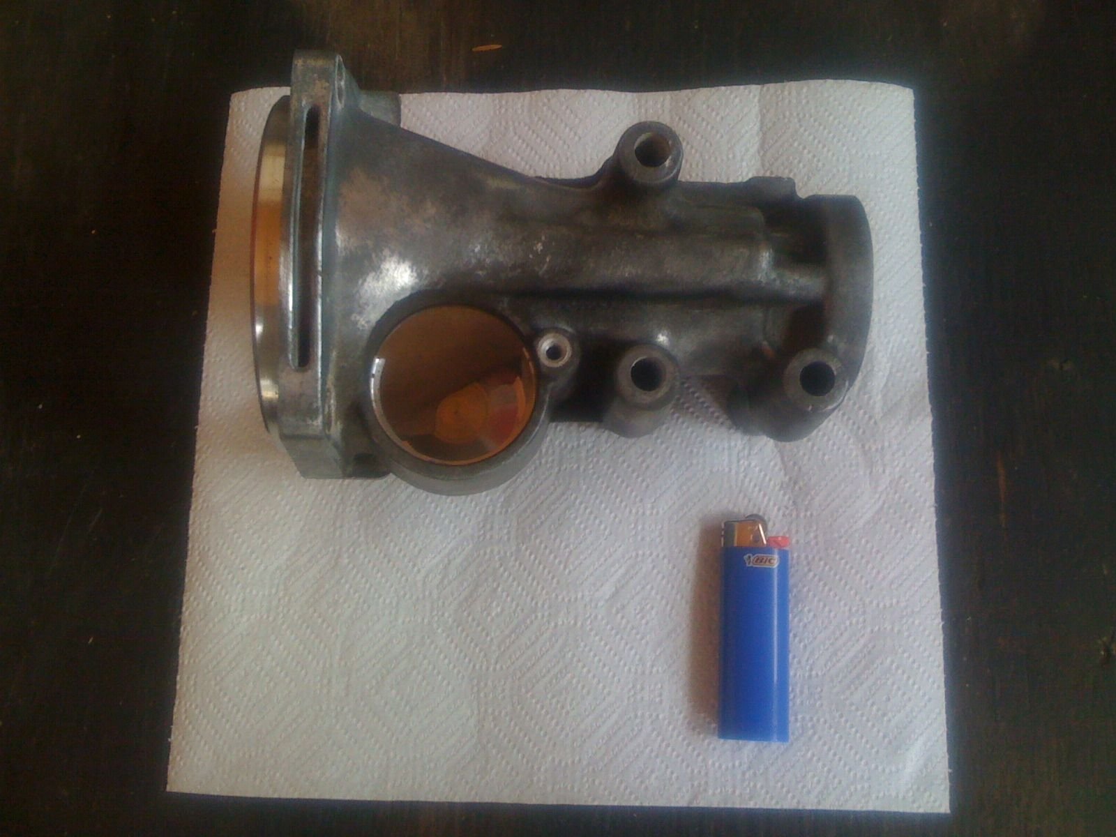

Hi ReillyH17, welcome to TGO
There is only one thing I know for 100% certain about the S10 transmission;
It does not have a provision in it's tailshaft housing for mounting the torque arm (that connects to the rear axle assembly). Your two options will be to get a tailshaft housing from a third gen specific T5, or get a "torque arm relocation kit" that will mount the torque arm elsewhere than the transmission's tailshaft. I do not know if any other S10 T5 parameters are different from our third gen cars, and I suggest you do a search of "Camaro / S10 T5 swap" to ensure there are no other considerations.
The three holes cast into this (700R4) tailshaft housing are what the S10 transmission will be missing.
