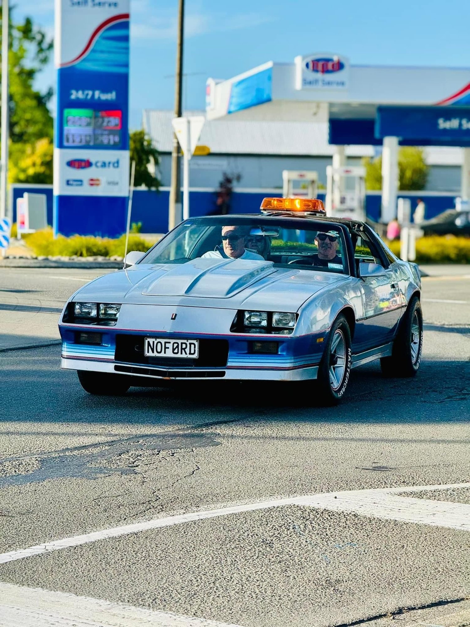

Hi Everyone
We own an 82 Indy Pace Car fully optioned. Unfortunately the previous owner replaced the rear differential with a 4th Gen rear end. I have sourced an 89 posi, disc rear end & replaced all wheel bearings & seals etc, now rebuilding the PBR callipers & brake lines. Due to the low ratio gearing (3.27) I want to get a bit more fuel efficient open road running out of her so my thoughts were to fit a 700R4 to give me that extra gear on the open road. As we are way down here in New Zealand, there are limited options locally.
Can anyone advise me on any fish hooks in doing this? Our car has no computer due to its age so not sure how the overdrive would be activated?
