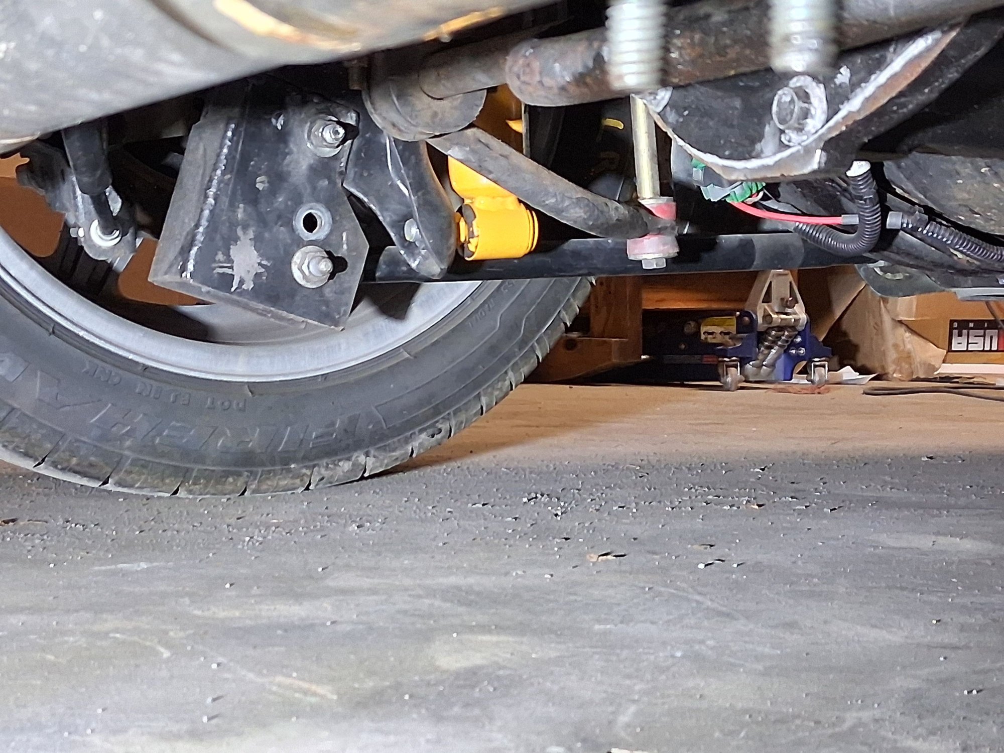

back to beat this dead horse. Here's the angle at now, would it be recommended to try and get angle even lowes somehow or is it more a problem of corelation of lower control arms vs torque arm angle now? Obviously I'm out of adjustment here, but I guess I could drill one more set lower.
I did check my 4th gen. That's all stock geometry. Lower control arms have a negative angle (arms go upword to axle housing). I have 0 wheelhop issues with that car though.
