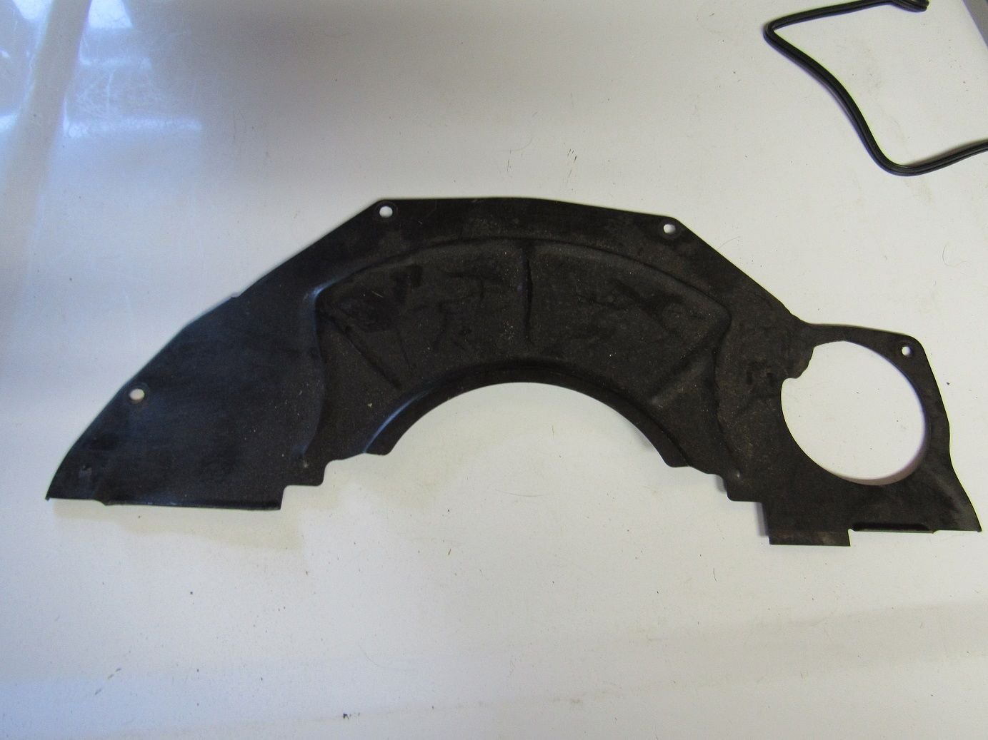

Hey guys, anyone know the bolt size for mounting the T5 dust / inspection plate? I'm getting a T5 swap package from another member this weekend but I think this hardware is missing.

The 4 bolts for this:

Oh that. The clutch inspection cover. I thought you were talking about something to do with the T-5 itself.
They're some sort of SEMS with unusually coarse threads. A sheet metal sort of screw. Very crappy. The BH where they attach frequently gets stripped. I always drill them out and Heli-Coil them to 6mm then use about 10mm long screws.

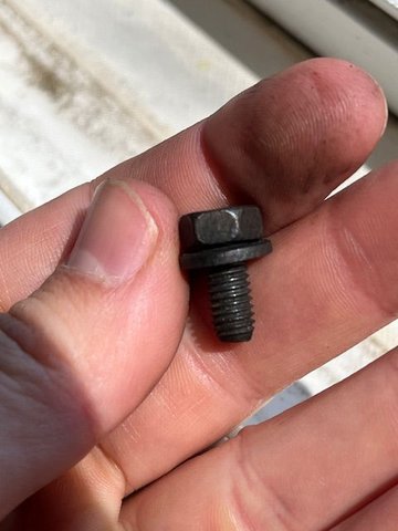

Mine are small bolts with washer (90 formula original), M6x1.0 - 12-13mm long (approx 1/2 in)
