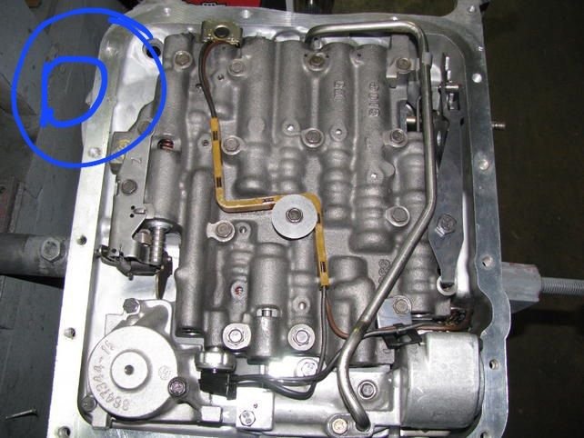

Your right about Not having the 4th gear pressure port outside on the passenger side, on mine its inside on the valve body. I've also heard/read a 8 second timed delay relay is also needed for when going in 4th it doesn't loc-up immediately. I'm not a fan of Painless Performance products...

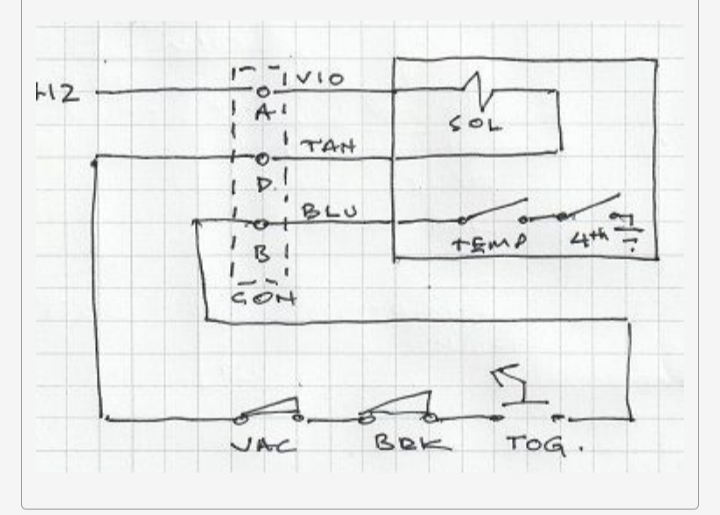

Your transmission should have all of the internal bits for OD. I've a 92 model in my non ECM Camaro.
I use a vacuum switch for load compensation (under the hood), the requisite brake switch and a valve body mounted temperature switch and the aforementioned 4th gear applied switch.
I've also wired in a manual toggle for disengaging the clutch should I want to.
TCC is only active in 4th gear and comes on simultaneously with 4th applied. It's not an issue in that regard whatsoever.
Here's a schematic of the components as well as the connector and associated colours used by the OEMs.

The option of the temp switch is just that. An option. My daily driver 06 Tahoe won't engage lockup when the trans is cold. Having the converter slip gets a little heat into the fluid which, when it's -40°, is definitely a benefit. I've more than one modified 4L60 and some have the temp switch and some don't. My current build does not.
As for the time delay, I never found a need for it. 4th and lockup are seamless. There's about a second or so before the telltale RPM drop happens when it shifts and that's the natural result of the electrical engaging the hydraulics. The time delay is an interesting tactic though.
The toggle switch serves a couple of functions. One, is that should I choose, I can switch it off and check that the TCC is indeed working. Troubleshooting more than anything. Another is using it for mild acceleration without having to drop into 3rd. Open the switch, moderate accel builds some RPM for an easy pass and then once settled down, re-engage. I'm not talking WOT here. More like enough throttle not to force a downshift.
What I haven't shown in the schematic is that I've also wired it for lockup in any gear. There once was the prospect of lockup in 3rd for chassis dyno tuning without getting to 150 MPH wheel speed. I know many that have done it but I also know it can be hard on parts as the fluid path changes with the TCC active.

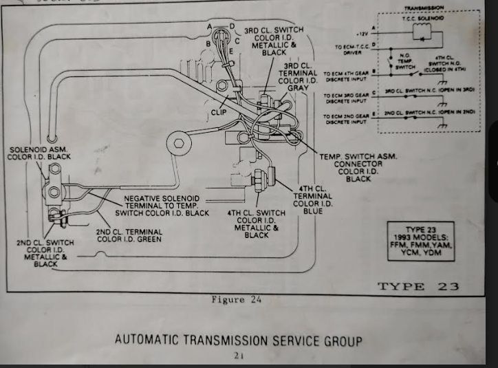

I've got a couple more since your on a roll here LOL.

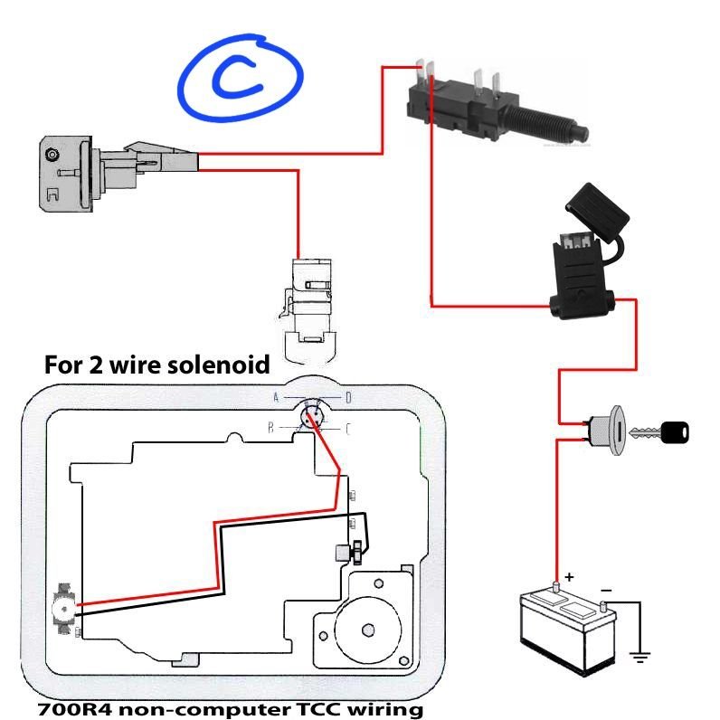

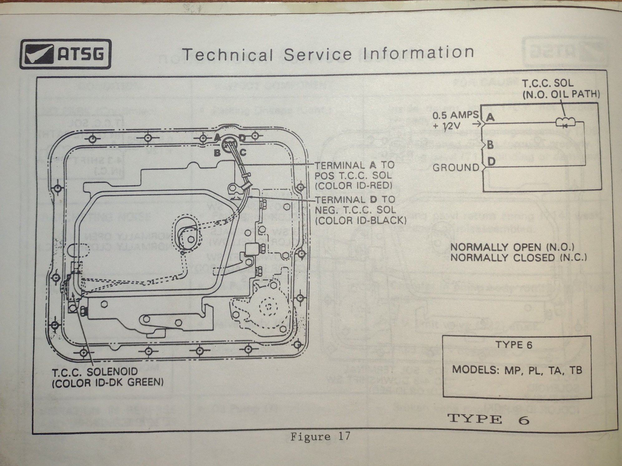

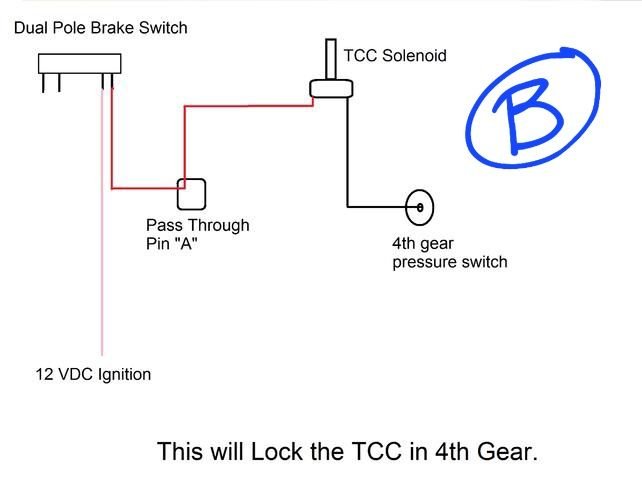

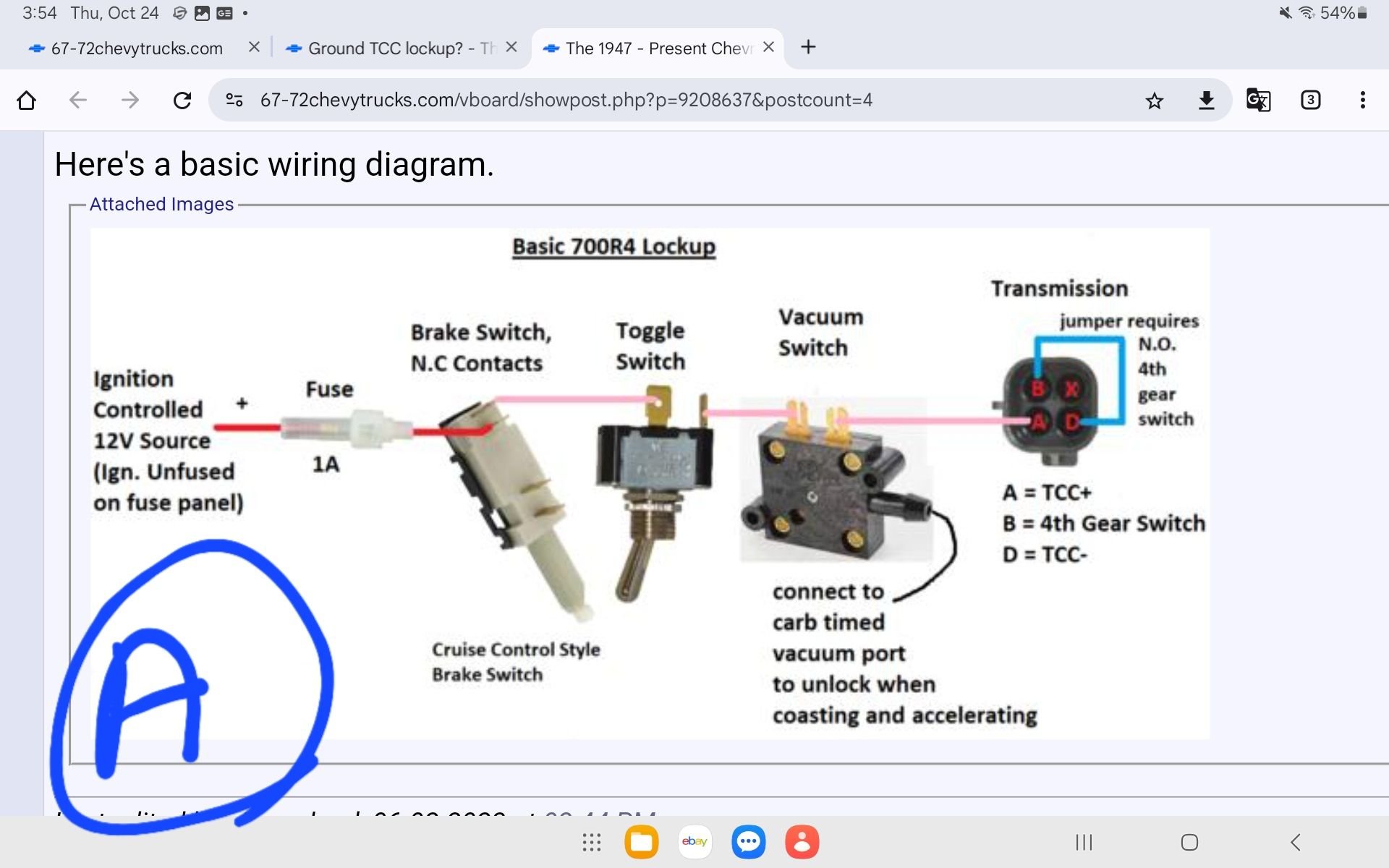

A - what is the function of or for the Blue wire jumper ( b to d ) at the main wiring plug?
B&C - seams pretty much the same as your Drawing but with some added items for a/the "one pin" 4th gear pressure switch system.
D - shows the incoming wire pathway from the main outside - a,b,d connector - one wire goes to the Solenoid then from there goes to the 4th gear pressure switch then from there goes back to the main outside square connector a,b,d - my question is what is the "function" of the wire coming from the 4th gear pressure switch doing on the outer side of the main incoming connector?
Why is there 1 or 2 pins on each of the Solenoid & 4th gear pressure switch? Im confused on that one.
My guess is it's a ground wire for the system to work it's magic?
Thanks in advance for any other advice and explanations.

Once I'm back at my computer I'll dig up the pictures I have of the valve body and wiring harness.
That said, the factory harness has a predetermined pinout (and colour code). This is what makes some of the wiring a little funky and not as direct as you might think. Remember in 92, it was ECM controlled so there's the element of the computer inputs and outputs and the harness works with those.
Once I'm into my pictures I'll be able to say with certainty why it's done this way or that. I'll also be able to explain the blue jumper in one picture in your post. I know the intention but I'll have to verify first.

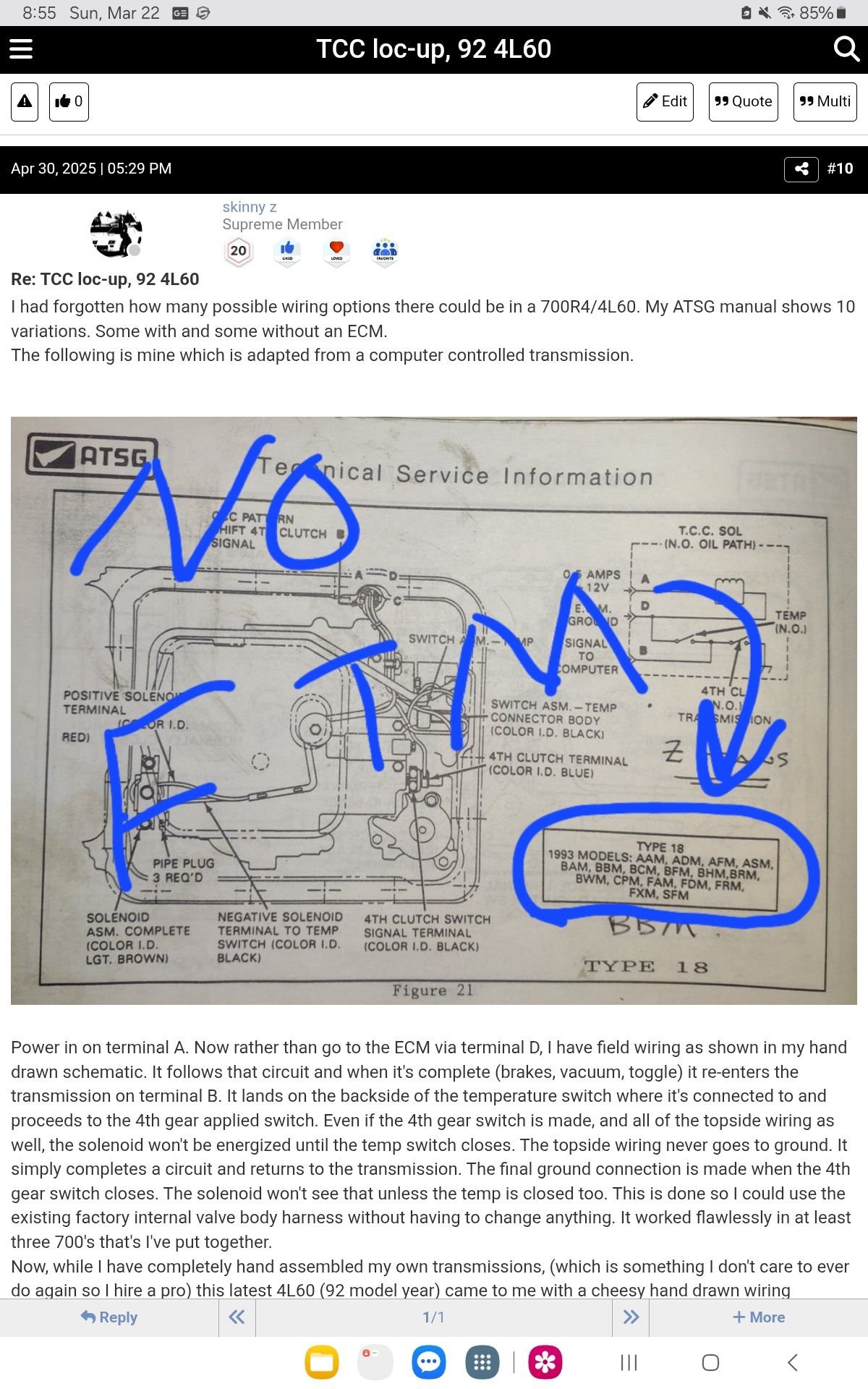

I had forgotten how many possible wiring options there could be in a 700R4/4L60. My ATSG manual shows 10 variations. Some with and some without an ECM.
The following is mine which is adapted from a computer controlled transmission.
Power in on terminal A. Now rather than go to the ECM via terminal D, I have field wiring as shown in my hand drawn schematic. It follows that circuit and when it's complete (brakes, vacuum, toggle) it re-enters the transmission on terminal B. It lands on the backside of the temperature switch where it's connected to and proceeds to the 4th gear applied switch. Even if the 4th gear switch is made, and all of the topside wiring as well, the solenoid won't be energized until the temp switch closes. The topside wiring never goes to ground. It simply completes a circuit and returns to the transmission. The final ground connection is made when the 4th gear switch closes. The solenoid won't see that unless the temp is closed too. This is done so I could use the existing factory internal valve body harness without having to change anything. It worked flawlessly in at least three 700's that's I've put together.
Now, while I have completely hand assembled my own transmissions, (which is something I don't care to ever do again so I hire a pro) this latest 4L60 (92 model year) came to me with a cheesy hand drawn wiring diagram that resembled a non ECM installation. It kind of looked like this.
Problem with that was it completely ignored the OEM valve body wiring and when I rejigged my topside wiring to suit what he had drawn, it didn't work. That's when I had to drop the pan (Grrr) and investigate. I found the OEM wiring and switch version of a ECM model and put it all together the way I had in the previous trans. Bingo! I was back in the game.
So further to your drawings and pictures, they represent a method that skips past the factory stuff and makes it super simple as the picture above shows. 12 volts in on terminal A and then the ground side of the solenoid leaves the case on terminal D looking for whatever method and arrangement of switches you have topside that eventually see ground and energize the solenoid.
There are several variations of that also as shown in your post pictures.
Feel free to ask any further questions. It may be as clear as mud at the moment but I'll help in whatever way I can.
Your options are many and varied. Check out what you've got and make a decision based on the sophistication you're after.

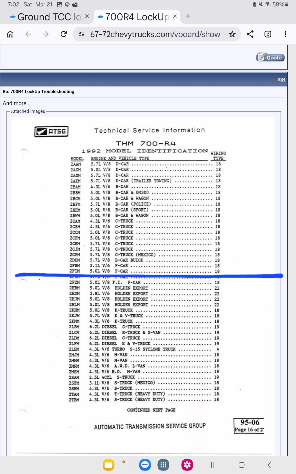

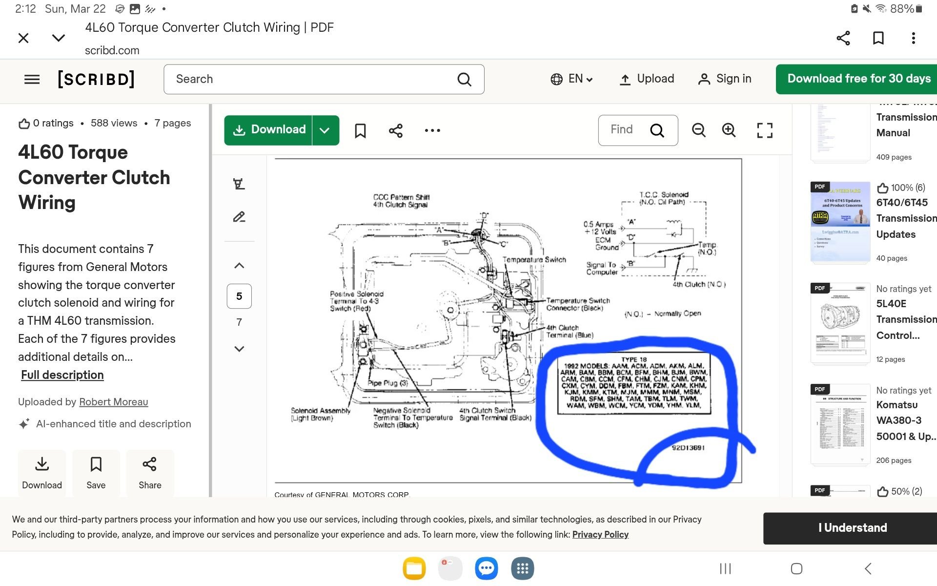

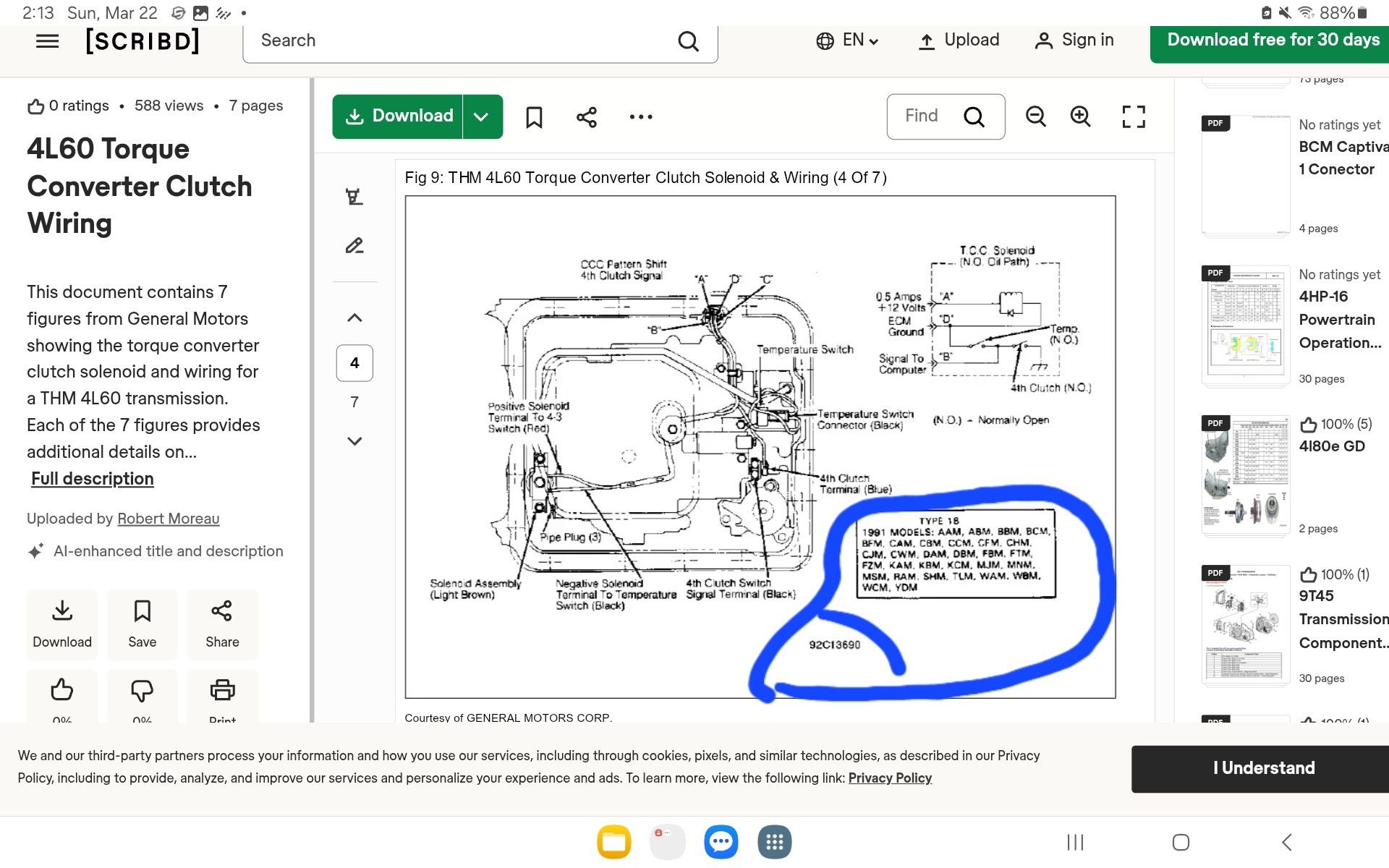

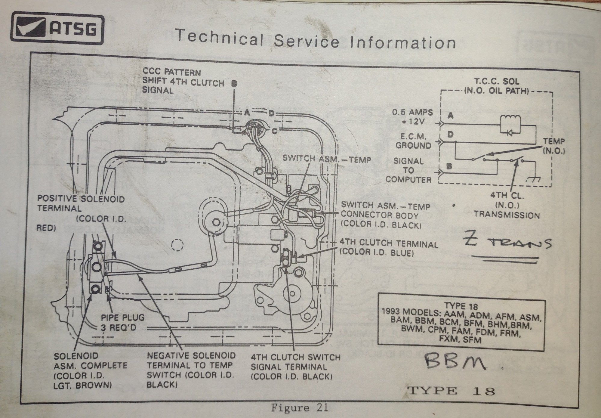

I know I should have caught this last year my bad that's on me LOL. Your ATSGs manual shows a brake down of model trans types used for #18 illustration for 1993 - mine is a 1992 "2FTM" those aren't in the Blue Circle I've provided pic below, also I've found this information about letter designations that use different types of letter designations types - I've shown in a blue line my trans's info.
Yes both years 1992 & 1993 show usage of illustration #18 but with different trans codes - mine FTM and yours BBM. Just confused on that one. Is it Safe to say both 1992 & 1993 year's use that #18 illustration info?
I HOPE IVE EXPLAINED EVERY THING CORRECTLY
Explained perfectly.
Interestingly, or oddly, the FTM isn't listed in any of the diagrams in the ATSG manual. Nor is anything listed as a 1992 model. The book jumps from 1987 (type 15) to 1993 (type 18). The closest they have to an FTM is as shown in the type 18 picture posted above. Next up is a type 23, 1993 model FFM and FMM.
I'll say it isn't safe to say if one is similar to the other. That is my (former) BBM and your FTM models.

FYI: The 93 type 23 (FFM and FMM) has a 5 wire harness.
In my case, I made my own wiring diagram (both then with the BBM and currently with a 1993 "K" cased transmission from a 4 x 4 truck) and wired the top side accordingly.
FTR: The BBM listed (which was the one used in my in my earlier IROC-Z) is wired exactly the same as the truck version and now in my 86 Coupe. And the only way I could figure that out was with the pan off and the wiring physically traced. Ultimately, neither were top side wired as per the factory. ( note the ECM reference above).
The only way to know for sure is drop the pan and have a look. A hint that there's a difference is the number of wires contained in the harness going to the trans. Any that I've dealt with over the years, and that's quite a few, all had a 3 wire harness with tan, purple and blue wires.
How they were configured both internally and externally varies. You'll notice in the type 18 diagram that they reference an ECM ground. I've no computer so I fashioned my own grounding circuit via vacuum and 4th gear applied switches.
What little info I have I've posted above "Detailed specs" and what not's - but somewhere in the forum 67-72chevytrucks.com I ran across a hole lot more of what was shown above or a lot more of the types # 1-23 details I'm thinking.
When I bought my truck I never noticed the loc-up or felt it finally in 4th gears loc- up position. So I looked underneath and found at the incoming plug NO WIRES going inside it's square 4 pin plug. Thinking the 5 pin is the 1993 4L60 "E" trans, also a 1993 4L60 "non E" ended it's run in 1993 serving only a few vehicles. So yes there is a 4L60 and a 4L60 E in 1993.
I'll look back on the "DARK SIDE" - 67-72chevytrucks.com for them other " types " 1-23 valve body pictures hopefully I'll run across a 1992 type #18 info.

The 4L60E, has to the best of my knowledge (and limited experience), a 20 pin connector.

NO Not using a ECM, as I see it the ECM only sends a Signal to the Solenoid then TCC is activated, I'm trying to do the same as a ECM does But With Out One using OEM style parts and some aftermarket parts. I know the Original Vacuum switch GM's # 14014519 isn't available any more but an Aftermarket one does exist and can be Dialed in for high or low Vacuum settings.
Here's some more on TCC Solenoid wiring similar to what's been posted but a little different in the blue circle/'s. Both show for 1992 FTM with different illustrations numbers close but not same.
I KNOW
I KNOW BOTH ILLUSTRATIONS ISNT THE BEST, HOPEFULLY THERE READABLE .

The 4L60E has a 20 pin connector. All of the shift solenoids need to controlled in addition to the TCC function. The wiring between the E and none E versions are completely different.
The 93 5 pin model I have in the ATSG manual shows pins A, B, C, D and E. All are used. It looks to be that this is a bit if a unicorn as it's the only 5 pin version. But it's not an E transmission. Just a plain old 4L60.

Below is a diagram of the way we would wire the Torque Converter Lock-up Circuit with modern wiring practices for Non-Electronic (No PCM) Fourth Gear Automatic-Lock-up with the ability to manually activate Lock-up in Second, Third, or Fourth Gear.
This Circuit will un-lock the Torque Converter if the Brake Pedal is engaged, if accelerating/ placing a load on the Engine, or down shifting out of Fourth Gear.
Otherwise while cruising in Fourth Gear, the Torque Converter will Lock-up:

I'm a wireman by trade. That said, understanding the wring is easy enough and as you stated earlier, there's more than one way to go about it. Yours carries a level of complexity that mine doesn't although I'll say I like what you've done. Keeping the solenoid load off of the control circuit(s) via relays was something I came across before although I can't say my "direct wiring" method has had any consequences.
One thing that stood out to me though is your manual selection in 2nd and 3rd. My fear in that regard is pushing what could be maximum engine torque through the single disc TCC. That's something my converter people advised me against.
The vacuum switch in my circuit is an OEM original and as such it's takes considerable throttle input with my combination of parts to open the circuit and release the clutch. Can't say what the TQ output is at that point but it's certainly not what's seen when loafing down the highway in O.D. at 75 MPH. I'd tried a couple of adjustable versions but the OEM performed best. This is just an observation on my part and I'm certain these are things you've fully taken into consideration.
From my post above, here's the hand drawn version of how I've assembled mine. (Upper left notation should say "+12v".)
I was tempted to add the direct ground as you did with your manual "applied" selection but I chickened out! The toggle shown above is strictly to keep the TCC disengaged.
