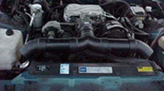

heres a dual filter set up that I was working on.
I just decided to go single.

thats what I wanted to do, but finding a 60* "Y" bend has proving to be quite difficult.
Sense you are going single, wanns sell me the "y" bend?
Single is till I get $$$ for the filters... sorry. It was 3 bucks I think at lowes. I really had to look for it though.

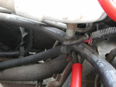

no special fitting needed. if you make your setup out of PVC, just use a paddle bit to drill a hole slightly smaller than the diameter of the sensor and the just screw it in. the teeth in the sensor will groove and seal right into the PVC. heres mine.

sensor went under the 45* bend
