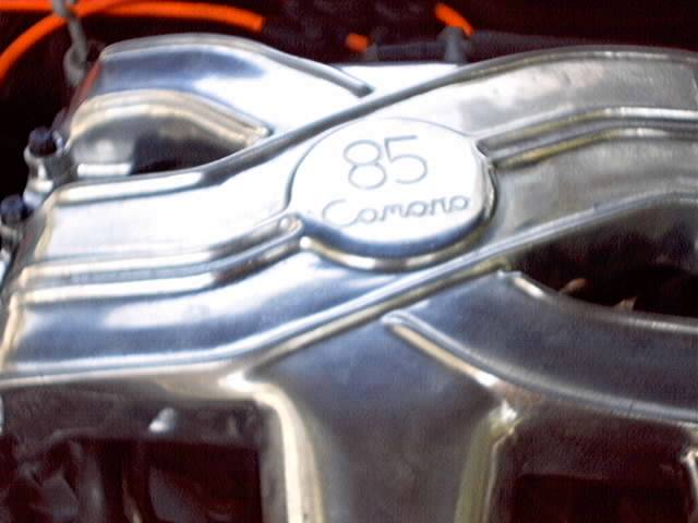

I did mine a loong time ago, I really need to repolish it. I used lots of sanding rolls 180,400 grit. Then I used a da sander with 320 grit, then with cloth polishing wheels I finished it off. Oh and I made my custom emblem and welded it onto the plenum.
