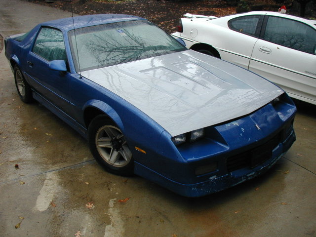

I dig the hood man..nice...where'd ya get it?? Looks like an aftermarket factory-design Z28 hood minus blisters... And.....do I see a 2.8 dual snorkel intake system rigged up to a 3.1 engine? I can still see the original filter can.. You know you CAN remove that...

That looks like the TPI intake rigged up to the 2.8/3.1 flex tube. Something similer to what I have on mine now
I do like the hood, and would like to know where it came from, esp if its fiberglass

i hope you like my riged up air cleaner and the boddems are cut out to . to increase flow
anywho i havent had time to take the old one out yet
the hood is one i got from a iroc z in a junk yard
i have a nother hood if any of you want it i look the same but no primer with no luvers for 75.00 but i will primer it 4 u if you want it for 10.00 i live in sc
let me know it steel
