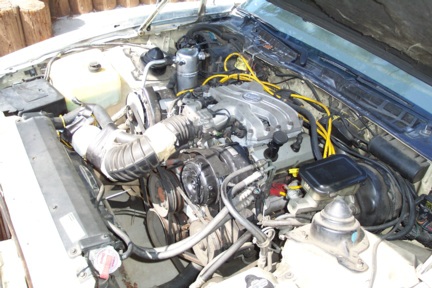

See my hokey air inlet set up?
GUESS WHAT????
SOMEHOW air was ENTERING AFTER THE MAS UNIT!
AND because of that, it sent signals to the engine to compensate.
NOW the hole, which I couldn't see yet "the car computer sensed" caused the bucking & lousy milage.
I replaced my hokey air inlet set up with the original factory stuff & the problem is gone.
So gone I also took a drive with AC on, to test.
Not a bucking problem at all.
Drive perfect again.
HEY A NORMAL CAR WHAT A CONCEPT!!
FYI, the engine sensing system, was reacting so fast, the computer (ECM) couldn't sense or prcess the information to offer a code.
Which is why I had no code appear.
The answer appeared as was hooked up a Snap On tool to read everything on the motor.
My fan kicks on at 221* & off at 200*. I was very happy to see those temp numbers, confirmed.
Not all home made fresh air set ups are the right solution, I just discovered.
