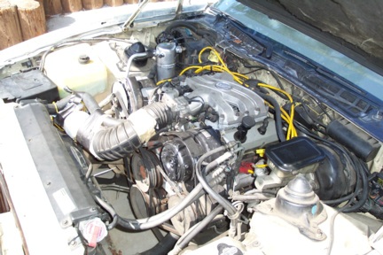

Mine is for an 85 Bird w/the MAF set up using the 3"pvc construction. The fillter is underneath the pass side "spare " battery tray. I have the AIT sensor on the engine bay side of the 90* elbow. I used rubber adapters to seal the air filter to the elbow, & the elbow to the MAF. I dremeled out the inside of the pvc tube & sealed the MAF to it. Next is the 30* bend into the stock air flex intake. I used the factory clip to secure this. Inside is another tube of pvc to keep the air from getting too much turbulence. This inner sleve stops right before the pcv return pipe.
Elbow & MAF
Front view of intake
Side view
Where the filter sits as seen underneath the car

Maybe you have seen this before but this is my setup for all those interested. Just some painted PVC and a K&N air filter. I drilled a hole for the IAT sensor which sits neatly right behind the filter.
Thanks,
Adam

hey, a "dredges up from the past" post that contributes, AND demonstrates teh power of the

very nice, looks real similar to the one that i had on my car before i put the TPI dual snorkel setup on it. except i had mine painted black.

BTW, VERY clean install AdmAnt13
~Max

Hey AM91Camaro_RS, do you have a picture of your new setup? Wondering how you did that.
And thanx myvmax1. I had built it and then decided that PVC was very ugly so I painted it and put a Firebird Decal on it (which is hard to see, the camera doesnt pick it up well).
