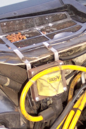

Here's how I mounted my coil, so much quicker & easier.
Attached Thumbnails Holley Ignition Module Install??-coil-20up-20-26

so in seeing your pic KED85, where did ya put the red, yellow and black wires too??
Old Mar 23, 2003 | 07:44 AM
KED85's Avatar
Posts: 7,604
From: ****SoCal, USA****
The wiring harness stayed exactly where it was.
ALL wiring went there. No tricks on that detail.
I merely mounted the coil in this position.
That bracket we have that holds coil over exhaust manifolds? I "removed the coil from that spot" placed it under "rain gutter" over hang.
I used thick strips of alumnium as you see. The stainless steel wire?
Holds the coil plug wire away from the coil to prevent chaffing of wire cover.
This is a very simple idea, try not to complicate it. I always use what the factory engineers designed, when possible.
My 1985 Blazer has the same idea and I've done that set up (also Accel coil) for over 100,000 miles of no problems. My Blazer has 211,500 on it.

Karl, is that an oil filled coil? Just wondering if it was meant to be installed upside down!

Tom
YOU GET MARRIED & JUST BACK FROM HONEYMOON?
Serious, on the coil detail.
I have no idea is oil filled.
I can say that my Accel coil in my Blazer (that's been there for over 100,000 miles) is in the same position, "wrong", not right side up.
No performance problems ever.
None zero zip.
I've even seen other GM coils in this position.
Serious, not a problem by mounting this Accel coil the way I show.
