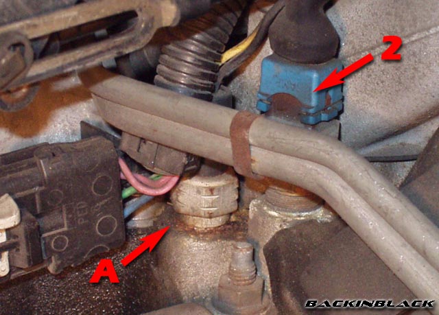

Ok, so which one is the Cold Start Switch and the other obviously is the Coolant Temp Sender???

From that long message about dennine2's car, in https://www.thirdgen.org/techbb2/sho...=1#post1297466
Originally posted by TomP
The sensors "in front off to the left of the throttle body on the intake" are the cold start switch (purple & tan wires) and the engine's CTS (coolant temp switch, yellow & black wires). If you're tracking a fan problem, dont' forget to check out the fan relay. If that's melted, the computer and/or the fan switch won't be able to kick the fan on. Don't forget about the fuseable links that run the fan, either; should be off the junction block on the passenger side of the radiator. The relay runs off a fuse in the fuse box.
Old May 28, 2003 | 05:42 PM
BackInBlackGP's Avatar
Posts: 344
From: Vermont
Car: 1986 W69 Special Edition
Engine: 2.8/ECM/Int/Exh
Axle/Gears: 3.42 posi
Hmmm... Well, mine are located to the right of the throttle body...
At least it's a start...
