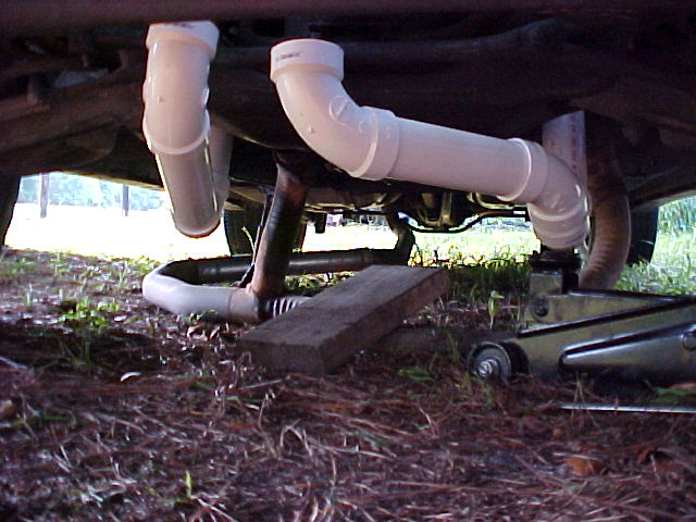

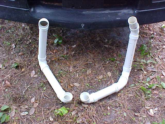

Chapter 2 = Prototyping the Exhaust
Pic 1:

'nother Pic

Old Jun 10, 2003 | 01:03 PM
Doward's Avatar
Joined: Aug 2002
Posts: 3,827
From: Gainesville, FL
Car: 1988 Chevy Camaro Hardtop
Engine: Turbocharged/Intercooled 3.1
Transmission: World Class T5 5 Speed
Ok guys, I'm off to work again... lol... gotta have the $$ for the piping, right?
I'll order the piping tomorrow. Saturday I'll order the boost gauge, and A-Pillar pod.

PVC in place... now you guys can get the jist of what I'm doing.
Keep in mind, the actual pipes will be a tighter fit, and better bent.

'nother

From under... this is where the actual pipes will be tighter to the chassis!

thats exactly where i figured the best position for the turbo would be. Only problem will be ground clearance, hehe.
Water and oil lines shouldnt be that much a problem, you could always do that once you have the turbo in place.

Yes. Before I can even route the intake plumbing, I need to mount the turbo up, first!
