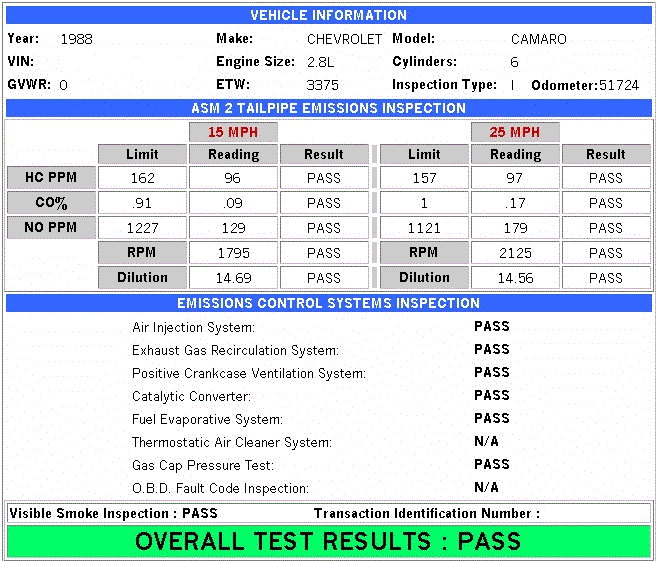

Interesting how MD does it in GPM, here is what my emissions from last July looked:
