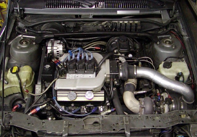

Originally posted by 1991tealRSt-topGuy
problem with that is, i've yet to see somebody build a fast one, its all talk
nobody on *these* boards have built fast ones.
I know plenty of other people who have built some fast 60's.
for instance: http://tiago.phxchevy.com/
New Dyno numbers are in, 336rwhp and 397 rwtq, still from the internally stock 3.4L. Impressive, even I am surprised how well it likes boost. Seems like Ive maxed out my current turbo, t72 comign up. Videos can be seen in the videos section.
That car is a time bomb waiting to explode- He has no reliability factor.
yeah i think those cast pistons might go poof pretty soon, he needs some forged pistons and copper head gaskets, then he should be good to go. 60v's already come with forged connecting rods.

How about this RWD 3.4 intake on a 3.2 FWD z24...

ah thats a 90* v6 cuosin to the 3.8 right ? um what exactly was done to put that intake on ther e? is it the 3.8 base etc or did somebody pull a fast one on me while i was sleeping. ive been looking at the 3.8 heads lately wondering if theyd fit a 2.8-3.1 60 v6 the more i look at them the more i think it should work. anyways id liek some detials on that bad *** looking sleeper. !
Thats curtis walkers cavalier. nope its a 60 degree v6 , runs mid 12's.
He just ran 12.49 http://www.turboz24.com/Files/12_49_run.wmv
Dont any of you hang out at http://www.60degreev6.com/ ?
Oh and my s10 ran 14.40's on a 100 shot with a few bolt ons with the old 2.8 motor.

1991 Cavalier Z24 Specs
Engine
Block : 1990 3.1 Vin V, vated, honed, powdercoated, Oil filter bypass removed
Crank Shaft : Externally balanced Magnafluxed and fully hardened
Connecting Rods : Crower bolt through sportman modified Small block
Pistons : Ross Forged racing pistons 8.0 : 1.0 compression
Rings : TotalSeal Racing Cromemoly
Camshaft Specs (Intake/Exhaust) : Crower Billet Mechanical Roller cam
285/277 advertised duration | 254/246 @ .05" duration | .6176"/.6016" lift | 114 separation
Heads : 1986 2.8 cast iron ported & polished heads with ARP 190,000 psi head studs
Head Gaskets : .040" GasketWorks solid Copper
Lifters : Crane roller mechanical
Pushrods : CompCams One Piece CromeMoly .083 wall 5/16 hardened Length intake : 6.300 Exhaust : 6.300
Rockers : Crane needle bearing roller tip forged 1.6 ratio
Springs : Crower springs, retainers, valve guides
Valves : SI Valves one-piece stainless steel, swirl polished
Plugs : AC/Delco Rapid Fire
Intake manifold (upper & lower) : 1995 3.4 V6 Camaro (modified)
Throttle Body : 1995 Camaro LT1
Valve Covers : 1986 V6 fiero
Fuel Regulator : Custom fuel rail mounted
Injectors : 52 lb/hr Bosch
Fuel Pump : 255 L/hr Holley in tank
Electronic Control : Haltech E6A with GM DIS module, Jacbos' Electronics DIS coils, and 3 bar map sensor
Turbo : Compressor – Garrett 60-1 / Turbine - Turbonetics T03 stage 5 .62 A/R ratio
Intercooler : Spearco model 2-115
Blow Off Valve : Greddy Type-R BOV
Clutch : Clutch Masters Stage 4 4-puc metallic
Rev Limit : 8100 RPM
Battery : trunk relocated Optima 800U
JetHot coated headers and exhaust
Custom crossover pipe
Custom 3 in. exhaust system
No Converter
Borla 3" in/out Sportsman Racing Muffler
Exhaust exists behind drivers door / in front of rear wheel
Suspension/Brakes
1993 Cadillac Seville front hubs, bearings, calipers, & 11.25 in rotors
1986 Pontiac 6000 STE rear bearings, calipers, & 10.5 in rotors
1996 Camaro master Cylinder with adjustable proportioning valve
ASA 5x115 bolt, 16x7.5 wheels
225/50-16 Yokahama A032R's
Eibach lowering springs
Tokicko struts and shocks
Poly control arm, swaybar bushings, and end links
Thats alot of work and expense for mid 12's. Those Fiero SC3800 setups would be alot cheaper, and should run on cheap gas.
Still this isn't in a Fbody. Lets see a fast V6 Fbody, that is done cheaper than a V8 swap. N/A should be compared to N/A. Power adders should be compared to Power adders.
