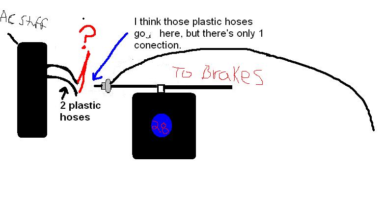

My car have 2 hoses, that I dont know where they suppose to go, I think that are vacumm hoses, when I turn the heater on It make a weird noise, like air going out some where, and when i put my finger on the end of that hoses the weird sound stops, I think I know where this hoses go, but theres only one conection, maybe some know where they go. or a pic of taht place under the hood.

I looked on my car, and there is 1 plastic hose going to the vacuum cannister above the brake booster, and the windshield wiper fluid hose.

does that hose goes all the way from the passanger side of the firewall, to the drivers side?

for the vacuum hose, actually it goes into a wiring harness, and down the firewall, but yes, from the pass side to drivers side.

As far as I remember, of the back of the intake, you have the one hose that goes to drivers fender, then that funky checkvalve T, then on that, then them go to the heat/air.
Then you have your own seperate fitting for the map sensor, which your a 2.8, so I dont think it has one.
