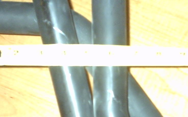

Don't know what everything around here has to be an arguement, especially when I am stating a fact. Unfortunately the camara flash will not come in clearer to read the tape but you can see that I have first hand proof that they are exactly 1.5" dia tubing. Also these are original out of the box uncoated (they did not come powdercoated) thin layer of black paint only Hooker headers for a 82-92 V6 Camaro.

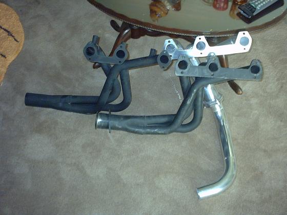

These pictures are from Agood2.8- Here are his Hookers, Heddmanns, and PF&Es for comparison. You can see the primaries on the Hookers and heddmanns are the same, but the merger is smaller on the Hookers at 2 1/4", while the Heddmanns have 2 1/2" merge collectors

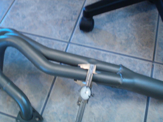

i don't want this to be a big arguement. but, a tape measure is not a good way to measre tubes like that. i know that they didn't come powder coated, i powder coated them. this set in the pics happens to be Eric's. i powder coated the set i have on my car too.
look closely, that dial caliper is showing just a few hundreths shy of 1.4" and again, that's with a couple of good coats of powder on there which can really be pretty thick.
