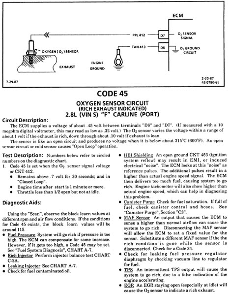

Click this for the 2.8 version of code42 & troubleshoot procedures

Thats nate. My helms manual confirms that 42 is from when I was setting timing.
This code 15 I'm wondering if its a short in my wiring. It doesnt come on all the time.
45 Is really pissing me off, and not sure if its even associated with my stalling problems.

Hey I have checked....
1. Fuel, 40 car off, 38 car running, rises to 40psi when I rev engine (so actually low)
2. rich injector, I dont have tools
3. leaking injector, I tested before I installed them, no leaks (still no blead off on pressure guage letting car sit)
4. hei shielding, not fully understanding this, but I added extra ground straps when I installed engine, I removed them thinking it might be making "noise". No change.
5. purge cannister, not yet, hardly hear of these going bad
6. map, I have changed, checked and made sure the port on intake is clear, it is.
7. tps, checked, adjusted, re-checked
8. egr, whats that? I dont think I have one of them
Just came back in from checking pickup coil, coil, crimping ends on plug wires. I am not sure if my coil is reading right (wish step 3 was more clear), pickup coil is fine. Vacuum is fine.
I started car and watched my 02 meter, it started out reading right, and every time I reved engine, and the warmer the car got, the higher/richer my reading was. This kinda tells me it is heat orianted, and whatever part is failing the warmer the engine/parts get.
