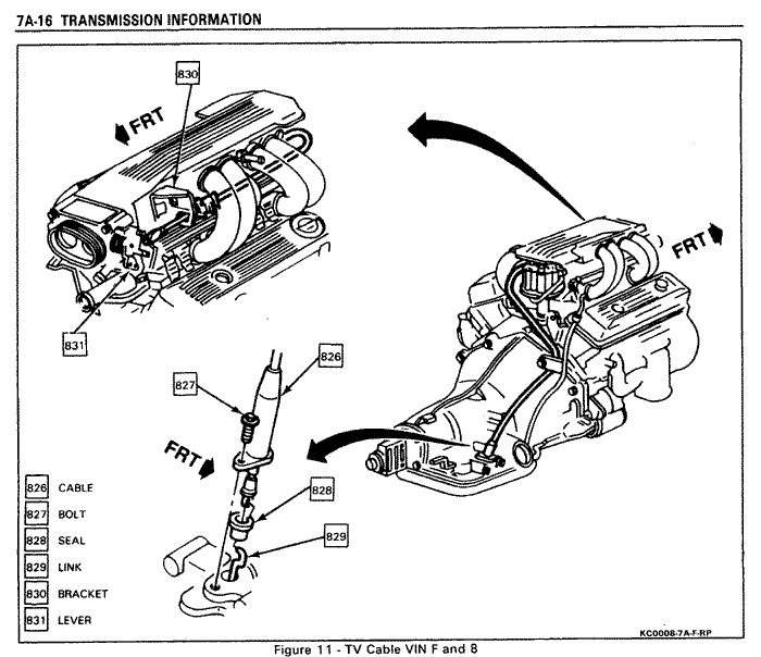

The TV (throttle valve) cable controls the shift points in the transmission while you are driving. Here is the picture of it.

how do you see if the cable is right and reset it ????
thanks trickster and captpicardsz28 :hail:

You can check for cracks or breaks etc. in the cable. There is a tech article on how to adjust the cable on the home page. Check it out...

Hello Camarors8992,
To adjust the cable, look at picture #2 that I posted above. Take the re-adjust tab (832) and push it in, it is hard so use a screw driver to do it. while you have it pushed in, take the cable (826) and pull it in the direction of "B" in the picture. release the re-adjust tab (832) and have some one press the gas pedal all the way to the floor slowly. You will hear a ratcheting sound as it does, this is the cable being adjusted and nothing to be alarmed over. Save that for if you didn't hear it. Release the gas pedal and it is done.
P.S> You must repeat this process each time you disconnect the TV cable from the throttle body.

adjusting and re-setting is the same thing on this. This picture can explain it faster than me typing it.

The Carb question was directed at CaptainPicardsZ28 in response to his request. There is nothing that you have to take apart and the pictures in my first post are for your 3.1 v6 fuel injected engine. And you can do all those steps from under the hood by yourself if you like. Instead of having some push the gas pedal, you can manually open the throttle plate to wide open while you are standing next to it and no you do not have to look in the throttle body to make sure it is wide open. I think you can feel when the throttle hits wide open. The last picture I posted was in response to your post about what it is adjusting. The pictures and instructions can't be any simpler than they are. If you are confused about the direction "B" in that picture is pointing, it is toward the firewall at the back of the engine bay. That is why I try to include pictures in my posts for items like this. It makes it simpler to understand if you can see a picture with items labeled.

thanks man that really helped me out alot i now understand it alothough i dont think it needs ajustmen cause with the peddle floored the valve is all the way

It's not the throttle body that you are adjusting, it is the throttle valve exhaust valve inside the transmission case that is being adjusted. Look in the first picture I posted at item #829 where the cable goes into the tranny case, that is what is being adjusted and being inside the tranny case I don't think you can see if it is adjusted or not. Think of this, if that cable is not adjusted correctly, your car will run lousy and shift gears even worse.
Here is a link to the tech article on this board that has an actual picture of a v6 fuel injected engine. Don't worry that it is a 2.8l engine, it is the same design as yours just .3 liters smaller.
https://www.thirdgen.org/newdesign/tech/detent.shtml
