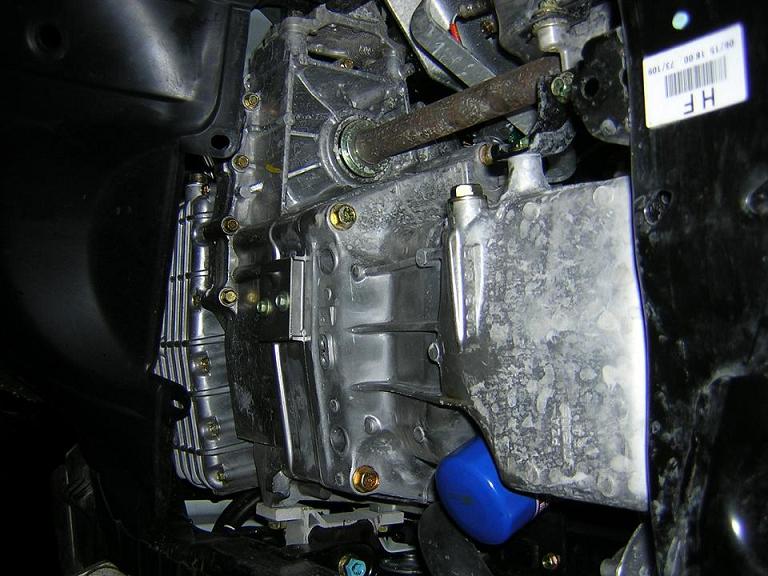

not to take away from this massive project... but i was checking it out... and doward, guess what the next turbo is goin on....
Attached Thumbnails Wow.. has it been too long between Turbo Updates?-exhaust-invert.jpg
