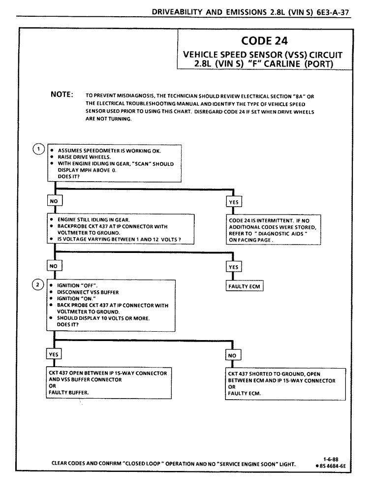

alright i decided to go and pull some trouble codes to see what came up, i got the standard 12
and then i got 2 quick flashes a short pause and 4 quick flashes, so i assumed this meant 24?
now my haynes manual says to disregard the code unless the cars moving, but not like they know everything.
does code 24 mean anything?

Nah, it don't mean much kretos. But maybe this will help you a little better than the Haynes manual will.

ah ic, so basically its useless gotcha
thanks as always trickster
