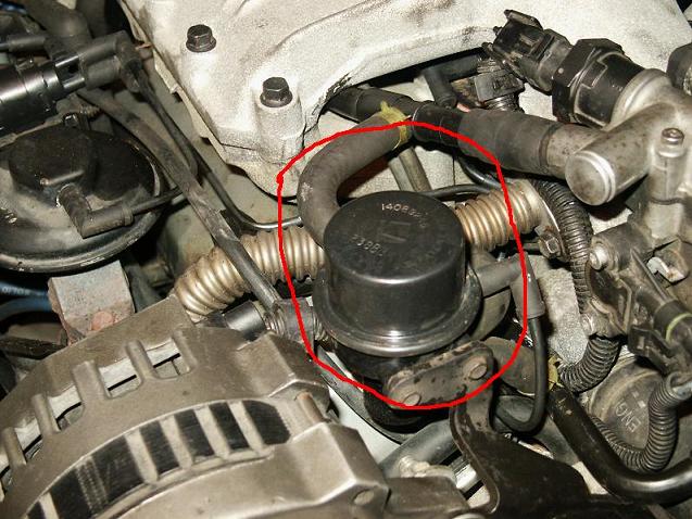

This is the motor I put into my 87 firebird. It is from an 88 or 89 camaro.
First pic: Do these connect to the cannister?

This engine must be an 88, cuz i have an 89 and i dont have that item in the 3rd pic. In the first pic, yes that goes to the canister, not too sure bout the rest.

The third picture is the deceleration valve for manual transmission cars. When you drive a stick and instantly let off the gas for shifting, you create a large pressure difference across the throttle plate very quickly. The decel valve slows down this change in pressure.
I think what Slow2.8 meant was it's a pre-88 engine, but that's not necessarily true. Only the manual transmission cars had the decel valve.

that engine looks exactly the same as mine, the third pic is as camaro_junkie said the deceleration valve, the 2 hose part is for the charcoal canister

Ahh, that smog pump motor is what I'm missing. My car did not have that originally so how do I get rid of this thing? Or can I just leave it capped off? This motor was from a manual car so can I also get rid of that thing as well since mines an auto?

The decelerator valve can be removed and you should do a good job of capping off the 3 connections to ensure you have no vacuum/intake leaks. Although it likely won't hurt anything to leave it on; it should always be non-operational in that case.
