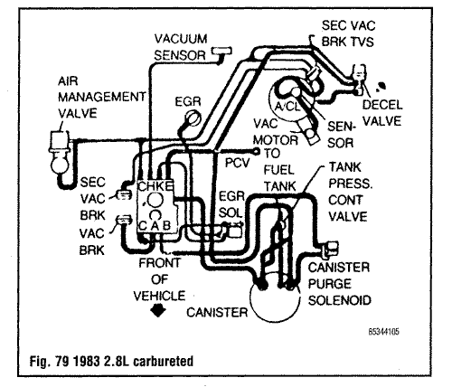

Going by the way your engines and cars are listed in your profile. Here is the schematic showing the vacuum routing for an 83 2.8L engine standard emissions.

So nobody's got any California '83 V6 smog sticker?
Hell if it helped emissions I'd swap the PCV valve to the passenger side and put the other tube on the driver's side... damned NJ dyno crap...
