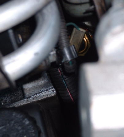

Driver side head at the front, single green wire, its right behind the a/c compressor .

alright, No the guage does not read high when the sender is dissconnected, it reads right at the white mark in between the 220 and the first white mark on the guage, am i correct in assumeing that the sender is bad?
